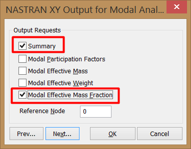

I run FEMAP & NX NASTRAN and I get the modal mass participation factors in both in the F06 file and cresated in FEMAP the functions for XYPLOT setting in FEMAP the following:
Pleae see if you are success with msc nastran.

1 Create FEM and request Summary and Modal Effective Mass Fractionws as shown in Blas' image

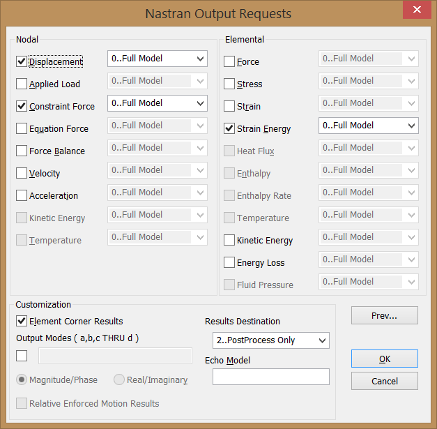

Hi Blas. If I select "Print and PostProcess" in the analysis settings, it will write it correctly as:
CODE -->
MEFFMASS(PLOT,GRID=0,FRACSUM,SUMMARY) = YES

This is done automatically when running FEMAP with NX NASTRAN, the XYPLOT dialog box controls the type of modal partic­ipation information that is written to the PRINT output file (*.f06). With other nastran flavors I don't know, here you are my NX Nastran output request settings:

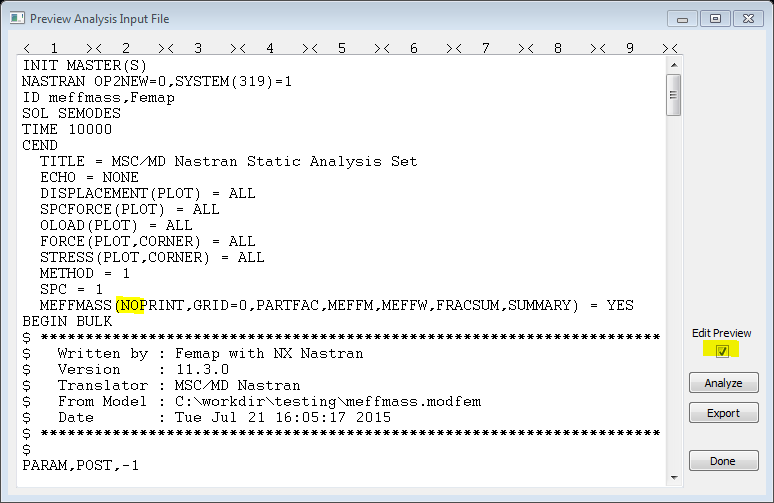

This does look like a problem when writing the MSC version file.
There is a pretty easy workaround for now.
You can use the "preview input" and then "edit preview" capability to correct the output request by removing "no" from the "noprint"
Then submit your run, and read the f06 file manually to create the functions as expected.

Also, as I show 3 posts up, it can be done in the analysis settings by selecting "Print and Postprocess."
