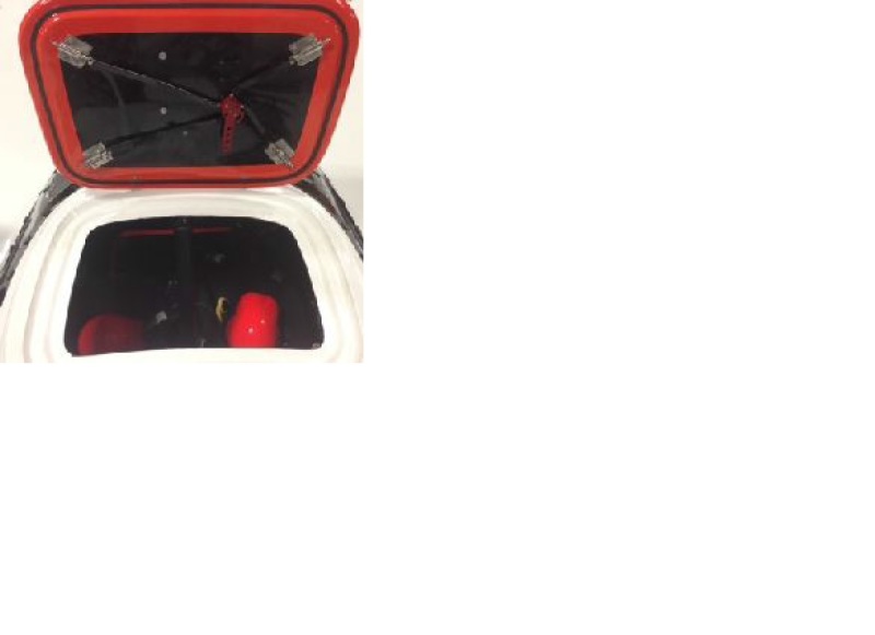

I was modeling a generic hatch from an offshore race boat:
In an accident these hatches often fail.
For your information, there is an F1H2O race organized by the same group as the Offshore; at Porto, Portugal on August 1 and 2. Both the Offshore and the formula 1 boat builders badly need engineering help (FEA) regarding their cockpit designs. They do not have the resources of the F1 cars. The race would be fun to watch.
