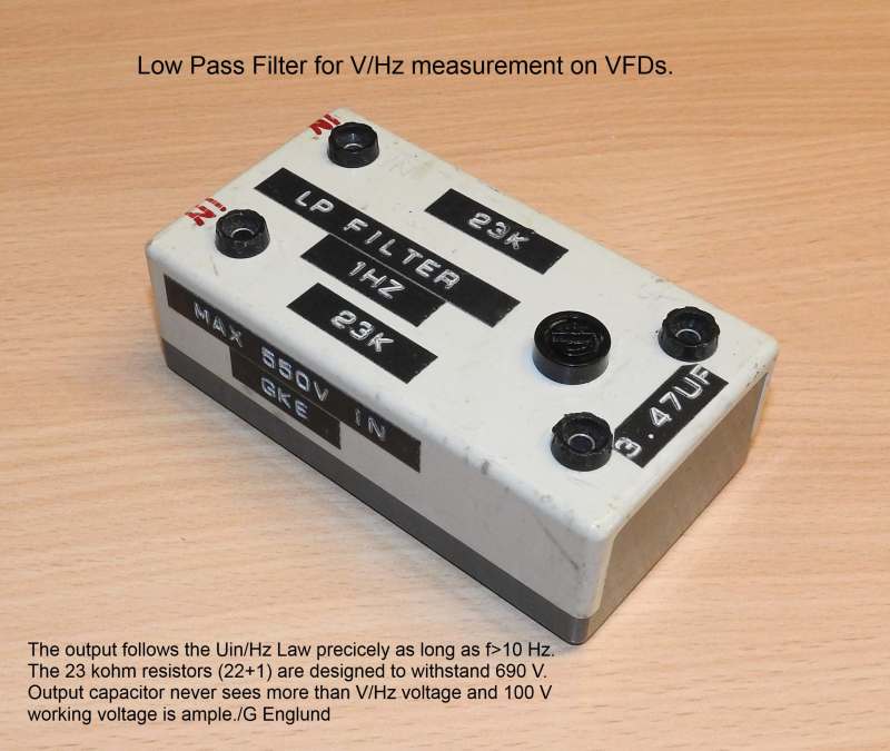

RE: Sinewave filter no load current
If Fluke, at last, has done something that works with PWM signals, I am the first to congratulate.
They haven't been able to do so before. They haven't even understood the problem.
For correct measurements, I use a symmetrical 1 Hz low pass filter. I then get the V/Hz ratio directly on the DMM and, if needed, I multiply with Hz to get actual RMS voltage.
Gunnar Englund
www.gke.org
Hi Gunnar
Will a simple RC circuit suffice or does your filter configuration require an op amp version with a few more bells and whistles?
Chuck
Yes - the simpler the better. Passive. See attached picture.
This filter was designed for 500 V but has been "upgraded" to handle 690 V. It is important to understand that flash-over voltage for small resistors can be as low as 250 V peak. So you need to se several in series to handle the 1000 V peak that exists in a 690 V system.
The capacitor never sees more than the V/Hz voltage. Usually no more than around 10 V. I have used the filter shown for more than thirty years without any mishaps.
Thanks, Doug, for the excellent upload picture feature!
Gunnar Englund
www.gke.org
