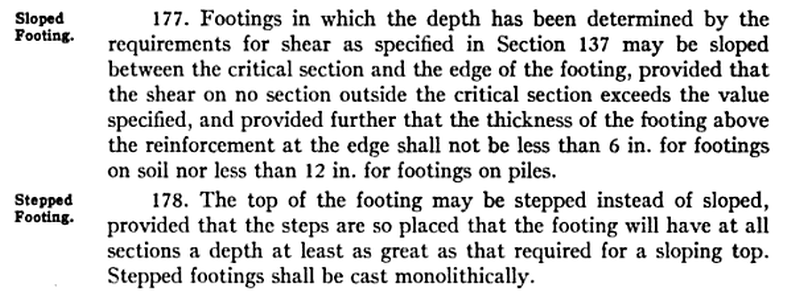

The "step" feature of a stepped footing does not have a specific structural purpose. It real use is to save concrete and the shape is to make the formwork simple. As long as the footing's concrete thickness is adequate to resist shear, the step can sized and located as desired.
Here is a quote and diagram from a 1921 ASTM paper:
The whole idea of having a stepped footing is a carryover from pre-concrete days when masonry footings were the norm. The masonry steps were sized based on conservative rules-of-thumb that in turn came from experience. When reinforced concrete came into use, soil mechanics was advanced enough to allow informed decisions to be made, instead of following tradition.

Thanks for the input, folks, that was exactly the information I needed.
