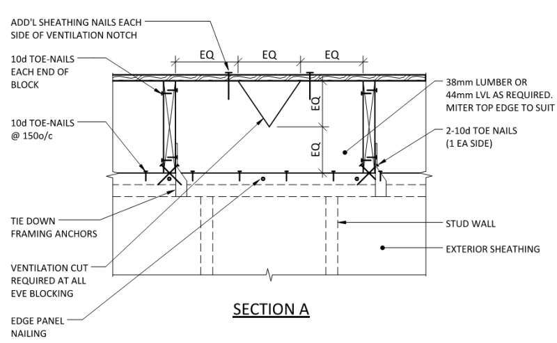

In my Breyer book they don't go into any detail about the discontinuities of a roof diaphragm at the ridge due to ventilation requirements. In the Breyer ridge detail (Page 9.28 Figure 9.10e of the 6th ed.) they show the sheathing as continuous. Not sure how that's realistic.
For the job I'm currently doing, I have a gable roof. The attic is finished so I was just going to use the rafters to transmit the lateral wind load into the attic floor diaphragm. But what if the attic is unfinished, how have some of you resolved this? Treat each roof face as two separate diaphragms?
You could put blocking at the sheathing edge near the gap at he ridge, but this would disrupt air flow from the eave is the ceiling is finished. But I guess you have a finished ceiling, you'd have an attic floor to use as a diaphragm. So is that how you guys do it?
Curious as to what others do. Breyer advises to use "ATC Guidelines for Design of Horizontal Wood Diaphragms 1981" for steep roof diaphragms, I might have to pick it up. Anyone else us it?

heck of a detail you have there Kootk. Contractors where I live wouldn't like doing that too much and/or they'd screw it up lol
Either of you try doing each half of the gable as an independent diaphragm assembly? I guess you could use each gable end as a shear wall for both. If the loads aren't too high, it should work no? Thoughts?
RE: Wood Gable Roof Diaphragm
Yeah, I don't have high hopes for the detail. Any minute now, I fully expect that XR250 will show up and mock my attempts at theoretically correct light frame wood engineering. The "Medeek Zone" as it's come to be known.
I've thought about the split diaphragm. However, the two split diaphragms would each need their own chords at the ridge (loads parallel to ridge). That would require blocking and strapping which would seem to be quite terrible as well.

That is one heck of a detail KootK, I'm assuming this is for a commercial job or a very large custom residence.
I haven't given the ridge vent question much thought up until now. I recently did a garage design and engineering with a continuous ridge vent running the full length of the ridge. There is a 2" sheathing gap at the ridge to allow for airflow. Without a doubt the roof diaphragm is bisected along this line. See my typical (non-structural and overly simplistic) ridgevent detail below:
The first problem with this detail is that the dashed line indicating the #30 felt is not clearly visible, but that aside there is no consideration given to the discontinuity in the roof diaphragm. Granted all of my typical residential diaphragms are unblocked (low unit shear) diaphragms.

My detail was for the ridge truss spanning across the chapel of a church. It was one of those frustrating wood situations that I always seem to find myself in where the numbers steer me towards a) a ridiculous looking detail or b) turning a blind eye to the numbers.

In figure 9.10e Breyer shows a shaped blocked along the ridge with cont. nailing at the panel joint along the ridge. He also notes that the trusses probably have sufficient strength and stiffness to maintain diaphragm continuity at the ridge.
With a ridge vent the blocking at the ridge is a problem as shown in Breyer's book. Would blocking at each side of the ridge work? Maybe oriented flatwise? This still does not really fix the discontinuity in my opinion but it does give a blocked edge.

Quote (Would blocking at each side of the ridge work? Maybe oriented flatwise? This still does not really fix the discontinuity in my opinion but it does give a blocked edge.)
While I know of no way to formally quantify the improvement, I feel that this would help a great deal. As discussed above, the blocking can't serve as chord without strapping for tension. However, even without strapping, the blocking would serve well as a collector to better deliver the shear to the truss top chords.
I've been using the blocking detail shown below which is a ripoff of a similar detail that I found in the TJI catalog.
This is kind of what I have in mind:
That's it. Now that I see the detail in real life, I have to question the capacity of the truss to transfer the diaphragm shear from one side of the ridge to the other. What's the reliable capacity of a truss plate loaded in withdrawal?

So what was the final consensus on the detail I posted above? Does flat blocking at both side of the ridge gap make sense? I've actually never seen this done on any residential roofs. My brother used to run a roofing company in Utah and I remember him sheathing the roof and then running his circular saw along the ridge opening up the air passage for the ridge vent. No thought was ever given to structural problems with this configuration.
If you look at a simple rectangle structure with four exterior shearwalls and then consider a lateral force parallel to the ridge the shear in the diaphragm is technically zero at the center point.
In the other direction with the lateral load perp. to the ridge is probably more problematic. One could consider the diaphragm as two separate diaphragms however what to do about the absent chords at the ridge line for both diaphragms (one in tension the other in compression)?

My contribution to the consensus is as follows:
- I think that the blocking helps a good deal.
- I've no idea how to quantify the help provided by the blocking.
- Even with the blocking, I think it best to consider the entire diaphragm as a single unit across the discontinuity.
- I'm going to omit blocking and using only unblocked diaphragm values for fear of getting molested on site.

No time to draw a picture. Saw a condo being built here in SoCal with conventional double 2x12 ridge beam, roof sheathing both sides boundary nailed to ridge beam, 3" holes drilled through roof sheathing just outside the ridge beam on both sides and spaced so only a percentage of the diaphragm was penetrated, then a wide ridge cap was placed covering the holes. The composition roof tiles were held back to expose the holes but were covered by the vent.
