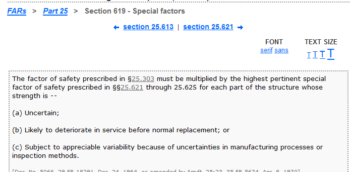

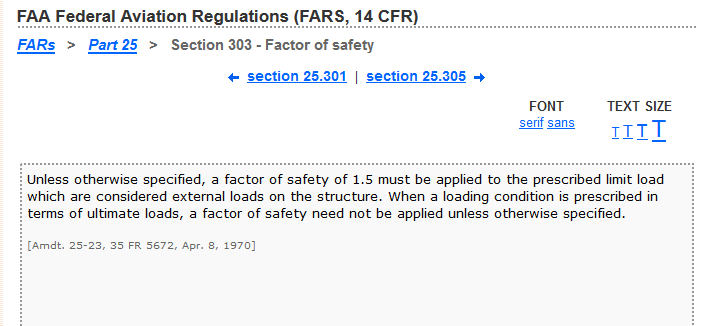

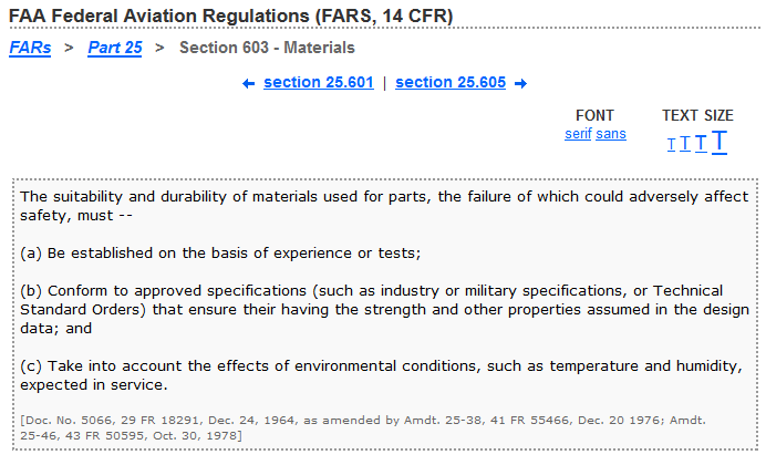

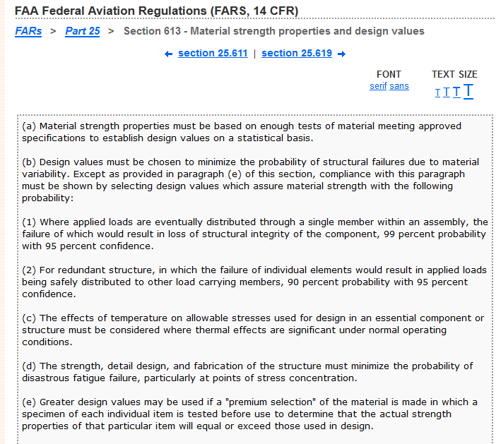

It's hard to keep up with wktaylor. But here are some examples of what the US FAA FAR part 25 regs say about the material property basis used for analysis of transport aircraft structures:
I hope that helps clarify the issue. ponder
