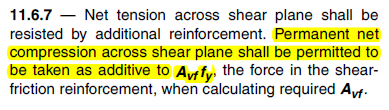

Shear-friction ‘rides’ again, but with a bit of a twist that from my forum search has not been specifically discussed!
As per ACI-318-11, section 11.6.5 on shear-friction states:
For f’c = 4,000 psi, the maximum value of Vn is 0.2f’cAc (or 800 Ac). So basically it is stating that a maximum of 800 psi for 4,000 psi concrete.
If there is a permanent applied compressive stress across the interface, then 11.6.7 permits this value to be added to the rebar passing through the shear plane too:
And clause 11.6.6 states:
So in the case of NO rebar passing through the interface, then it therefore implies that the maximum applied P/A is 800 psi from the permanent applied compressive force, AND if high-strength PT bars pass through the interface (that actively applies the permanent compressive force) the maximum stress in the PT bars must only be 60 ksi (or 40% of their UTS, assuming 150 ksi PT bar)?
Appears to heavily penalize the use of ACTIVE prestress across an interface.
Am I missing something or interpreting something incorrectly?

Quote (Ingenuity)
It's Vn/A that is limited to 800 psi, not P/A.
Quote (ingenuity)
I interpret the 60 ksi limit to only apply to passive shear friction reinforcement. I don't believe that it should reduce the clamping attributed to prestressing.

I want to agree with you re 800 psi BUT...11.6.7 does state that the "permanent net compression across the shear plane shall be additive to Avffy", and if Avf is zero (no passive grade 60 rebar), that means max permanent net compression across the shear plane is therefore limited 800 psi, which is a round-about way of limiting the P/A if that is all you have across the shear plane.
Commentary R11.6.7 has a reference 11.44 that I shall read up over the weekend:
Reference 11.44 is paper by Mattock and Hawkins entitled SHEAR TRANSFER IN REINFORCED CONCRETE - RECENT RESEARCH here: Link
I too interpret the 60 ksi limit to passive shear friction, but the code is silent when you only have permanent net compression and zero passive rebar.

Quote (Ingenuity)
I disagree. It is not the compressive stress on the shear plane that is limited to 800 psi. Rather, it is the shear stress on the shear plane that is limited to 800 psi.
While the code isn't explicit in its treatment of what should be done when there is no passive reinforcing, my (our) understanding of shear friction fundamentals leaves me with little doubt as to what ought to be done in practice. The permanent net compression should replace the AsFy term in the SF capacity formula and that capacity ought not exceed 800 psi or f'c/5.

Quote (KootK)
Thanks KooktK, I agree. A star for you! Could not see the forest for the trees. Obviously should be shear stress.
The PT would be UNbonded during construction, then grouted prior to full-service. The PT is high-tensile 150 ksi bar - short lengths.
