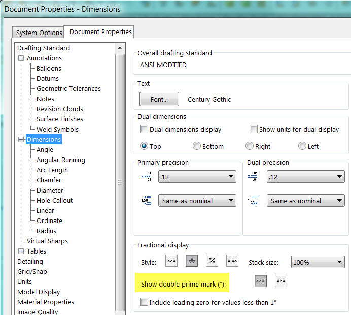

Hi SBaugh,
I do have that option turned on. The only case where they're disappearing is when I have the double prime mark bracketing the "@" symbol.

RE: Disappearing apostrophes from drawing notes
I tried typing it just like this:
BOLT <MOD-DIAM>1/2" @ 6" c/c and that was the output the " never disappeared.
If you RMB the note and select "Edit text in window" do you see the missing "?
If they are disappearing, then my guess is you need to try and replace your gtol.sym file... maybe its corrupted. However that is just a guess.

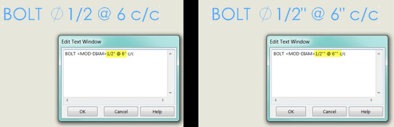

I think what you've got going on there is that Solidworks is assuming with the quotations and @ that you're trying to create a reference to a dimension or something (Like "D1@Sketch1"). Mine works exactly how yours does, if I have "<data>@<other data>" it returns <data>@<other data> without the quotations and makes the entire string one big block that can't be edited separately. If I leave out the " or the @ then nothing changes. Not sure what it is supposed to do in a note, someone else is going to have to explain this "functionality", but I think it is working like it is supposed to. Not sure why SBaugh's works differently, can't find options for that.
You just need to add the " twice and it shows up once. See in this image below:
I did not see that yesterday. This works alot like a registry file in Solidworks, you must have dual \\ to make one appear... must be a code thing.
That works. Thanks SBaugh!
