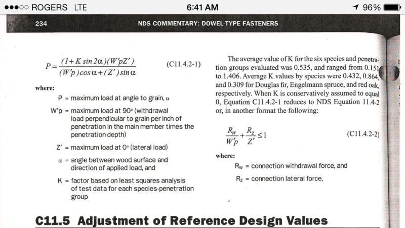

A question has come up on how to design nailing patterns for roof plywoood, considering combined interaction of uplift loads and diaphragm shear. I have typically done a linear interaction of tension/shear for fasteners, but can't find any direct language to this interaction for engineered panels. Basically, if I use the APA tables for allowable horizontal diaphragm nailing, and want to also consider nail withdrawal for simutaneous uplift loads, what is the best way to calculate this interaction? There is an equation in NDS for interaction with nails, but it is based on individual nail capacities, not engineered panel capacities.
So I am thinking to calculate the number of nails in a 4x8 sheet of plywood, based on the diaphragm capacity tables, then work out the total uplift on that 4x8 sheet, then using the withdrawal capacity of each nail, calculate the total allowable uplift load based on the number of nails. Then I could do a linear (or otherwise) interaction of the withdrawal tension and diaphragm shear. This is the same approach we use for metal deck fastening patterns. What do you think?

For reference, the non-engineered panel interaction equation is shown below (2005 NDS). Two additional complicating factors:
1) In a blocked panel, only the 4x8 sheet perimeter nails are loaded in shear. The interior nails should be 100% available for withdrawal. Well, almost. The interior nails are needed to prevent shear buckling within individual plywood sheets. That buckling prevention itself would induce withdrawal loads. I'll wager this are small loads however.
2) In an unblocked diaphragm, shear transfer between two of sheets is rather complex and would involve some of the interior nails. Frankly, I wouldn't know how to calculate the shear per nail in an unblocked diaphragm without veering way off into "making stuff up" territory.

True enough. Clearly, all the nails in a sheet of plywood will contribute to both. However, along the perimeter edge of the sheet, the trib for uplift is much less than in the field of the sheet, just due to the nail spacing. So the uplift force on the edge nails will be less than the nails in the field. Conversely, the shear in the field nails will be less than along the edges. So my thought was to assume that the shear is taken only by the edge nails, which should be a conservative assumption. Then using the uplift trib on those edge nails, work out the withdrawal force. Then using an shear-withdrawal interaction (linear or otherwise), check the adequacy of the nails for the combined loads, with the nail spacing based on a diaphragm shear capacity table.
So as an example, say we have a diaphragm capacity of 360 plf with 8d nails @ 4" o.c. along edges and 12" o.c. in the field. Now say we have an actual diaphragm load of 240 plf, and an uplift pressure of 100 psf. So we have the following:
n = 12" / 4" = 3 nails per ft along edges
V = 360 plf / 3 = 120 lb / nail
V_allow = 1.6 * 83 lb = 133 lb (1.6 for wind factor and 83 lb per NDS)
Tributary area = 4" * 12" = 0.33 SF for edge nails with supports @ 24" o.c.
T = 0.33 sf * 100 psf = 33 lb
T_allow = 1.6 * 1.875" * 41 lb/in = 123 lb (for wind per NDS with 5/8" plywood)
Liner interaction:
T / T_allow + V / V_allow <= 1.0
33/123 + 120/133 = 0.27 + 0.90 = 1.17 > 1.0 thus no good.
5/3 interaction:
(33/123)^5/3 + (120/133)^5/3 = 0.11 + 0.84 = 0.95 thus OK.
So now the question is what type of interaction: linear, 5/3, squared
For metal deck I use linear, but for post installed anchors into concrete, most manufacturers recommend 5/3 interaction. I am inclined to use linear for nails into wood.

I'd stick with linear interaction, similar to what Koot showed in his phone screenshot from NDS. There's significant testing on concrete interaction to warrant the parabolic interaction.
