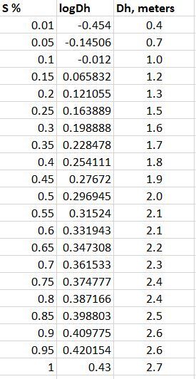

I'm reading one of the original Bartlett & Youd article (attached to this post). They cite the Shinano river plain away from the river face with lateral spread occurring on a 0.2% slope away from the river.
I'm still wondering about these measurements of an irregular topographic surface, taken with astronomical precision.
That's about a 2 milliradians angle, 2 meters of height over one kilometer of horizontal lenght, evidently it's an average over a large lenght of say, a few kilometers. So I would answer to the OP that, in this context of a wide alluvial plain or whatsoever plain, less than a 1/1000 slope angle averaged over a few kilometers sounds as a reasonably safe lower bound of the occurrance of lateral spreading.
It would also be interesting to carry out some sensitivity analysis over the formulas cited in the article. The formula (11) is logDh=0.430+0.442logS Assuming that's decimal logaritms:
Which means that slope, even if very small, has a significant effect by itself. But then we should carry out the sensitivity anlysis and scale out the effect of slope with the other variables, as in formula (20c).
