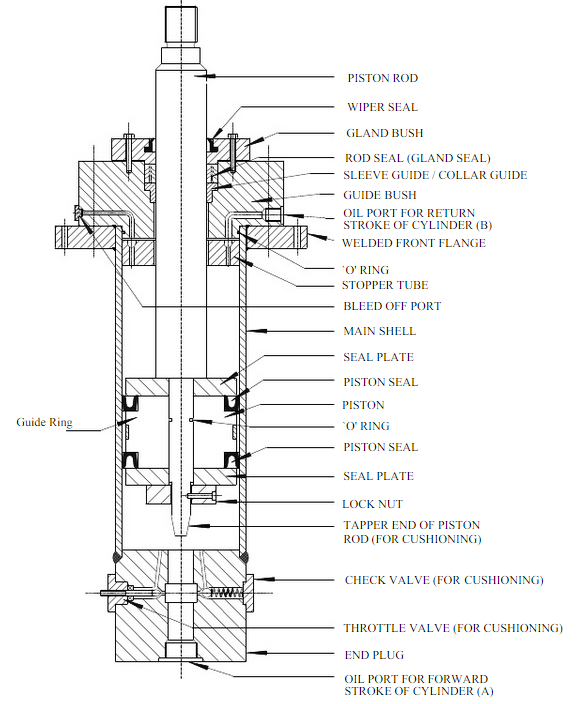

And one more question. Is cylinder like this considered as closed end cylinder:
I couldn't find anywhere exact definition what is closed end and what open end cylinder.
P.S. It's maybe obvious for you but I'm not that experienced and English is not my first language.
RE: Hydraulic cilinder
That one is closed at both ends. There's a space at the rod end (between the upper piston seal and the rod seal) which is "closed" to the extent that you can pump oil into it under pressure without oil squirting out past the rod.
By contrast, single acting cylinders are "open" to the atmosphere at one end. There's nowhere to pump oil in; if you did, it would just come out again and, importantly, you can't pressurise that end of the cylinder.
