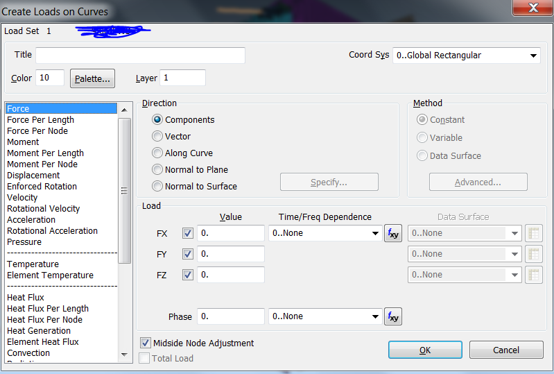

I have a beam assembly, i've added forces and constrains, and i have to add a uniform distributed load to check the deformation of the assembly. I can't seem to figure out how to add this distributed load onto the platform.

try element forces ... "force per unit length"

I have a 500kg/m^2 on the assembly, if i only apply the force on elements wouldn't that be incorect? (the force load will be smaller when i aplly only on element, than when i apply on the surface)

why not a simple nodal load (=P/n) ? it looks like you have lots of them !
RE: Force on surface
What about using curves to apply a force/area loads and then use the Model/Load/Expand to let Femap automatically assign the nodal loads?

You are showing the elements with cross sections. Do you have the underlying curve associativity? If yes, then use Model - Load - Curve. Many options there to choose from.
