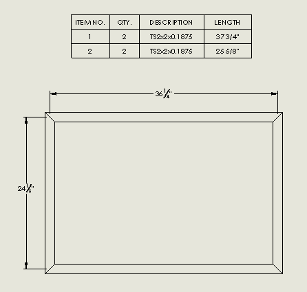

Hi, I have the same question as in this thread: http://www.eng-tips.com/viewthread.cfm?qid=204860
The solution stated there doesn't work for me. The weldment cut list stays at two decimals....
Thanks, Daan

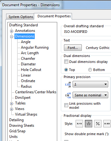

Hi, I use the 2014-2015 student edition. I see the problem now: I was changing the precision in the dimensions section. I should change the units in the unit section. Very confusing.
Thanks! Daan

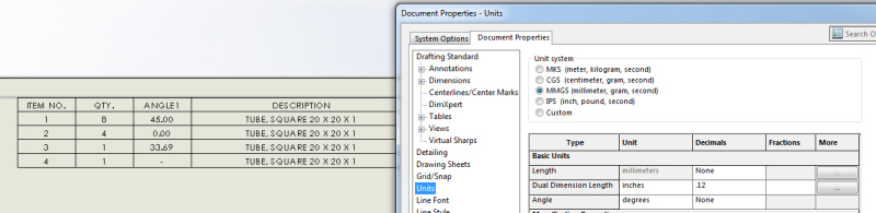

OK, this is strange. When I change the units decimals to none, the lenght gets updated, but the angle stays the same. Any thoughts on this?
RE: weldment cut list decimals
Change the units options when in the weldment mode, not the drawing mode.
What do you mean? Back in the part file?
Edit: that works, thanks.
