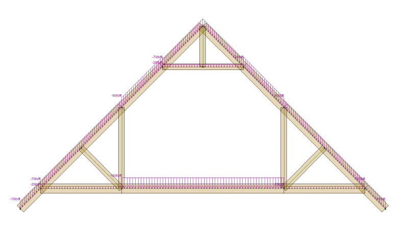

Has anyone else had much experience analyzing trusses (metal plate connected trusses) utilizing RISA3D?
I've pin jointed all of the web members and rigid jointed the heel and peak joints. For now I've ignored all of the load cases and just assumed one load case to get a better feel for the Axial, Shear and Moments in the various chords and webs.
Loads

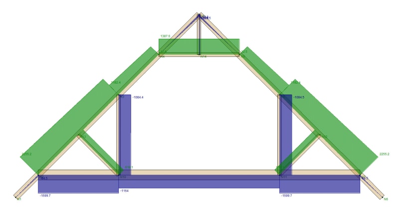

Axial
Shear
Moments

Well... instead of fix the apex and heel I would pin them. I would fix the sloped rafters as continuous embers and pin the rest.

Agree with Mike...the only fixity you need is to make a member continuous as it exists in the construction. Pin all the others.

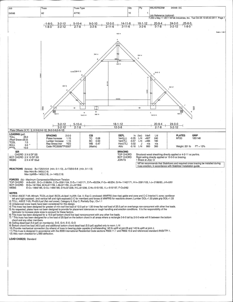

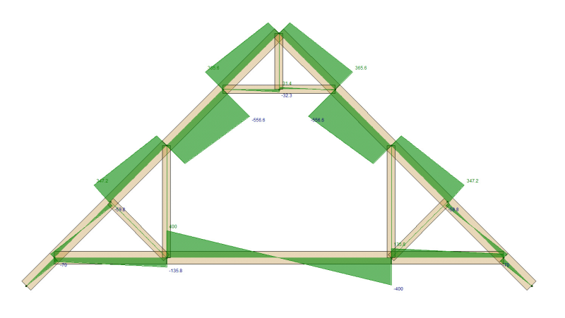

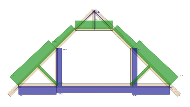

I've generated a model for a truss that I've recently worked on. My load case is #4 from the ASCE 7-10. I'm am trying to match the results as closely as possible to the Mitek report shown below. Changing the joints from pinned to rigid does affect the numbers slightly. The ANSI TPI1-2007 is somewhat confusing or at least a little unclear in my opinion on how exactly to treat rigid versus pinned joints at the peak and the heel. The Hr reduction factor given in section 8.3.2.2 implies that the heel joint does have some moment transferred across it and probably should be treated as a rigid joint. The peak joint is a little less clear. I typically treat all of the web members as pinned at their ends and hence only axial members, this simplifies things slightly.
All Joints Rigid:
All Joints Pinned except for Heel Joints:

My axial loads are for the most part quite close to the Mitek output. I am very curious though how they are treating the peak and heel joints as well as the web joints.

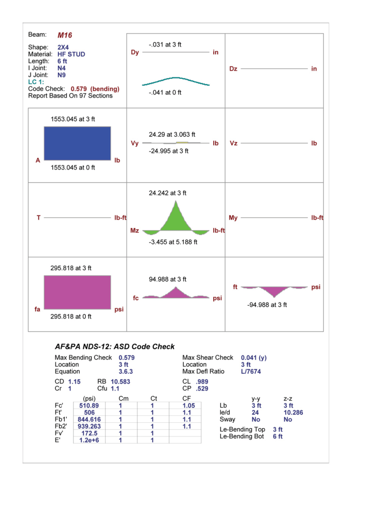

I am pretty stoked to find out that Risa3D will do a NDS code check on each member, have never really used this feature before. A word of caution though, you need to carefully setup the unbraced length for each member in one of the spreadsheets.
My combined stress indexes are coming in a little higher than the ones generated by Mitek so not entirely sure that I have all the adjustment factors correct. For example the highest stressed web member is the ceiling web that is in compression and bending. Its CSI is .58 which is slightly larger than the WB = .47

I believe they treat the heel and peak joints as pinned as MSquared mentioned. I don't think their software or testing is that sophisticated to do otherwise.
I have had instances where a contractor has hacked up a few of these for flues. They are really hard to fix as they are usually pretty highly stressed if the span is long.
RE: Attic Trusses
I don't see anything in the heel connection that would transfer moment.
Remember...just because we model something in a particular way does not necessarily dictate its action or response in construction.
It appears that the original truss design (assuming that's your last sketch) considered the heels to be pinned.
RE: Attic Trusses
I haven't scrutinized a version of TPI since the late 90's, when that was my thing. Back then there was a 'fictional heel modelling procedure" for heel joints to simulate the partial fixity generally expected there.
Truss heel heights are generally too high for a concentric joining of the chords and simultaneously not high enough to get a meaningful vertical web at the heel. You end up with wedge blocks, sliders, giant plates, and multie plates, all of which create significant potential for fixity,
I agree agree that the particular case illustrated in the sketches above would create something fairly close to pinned however.

Given the size of the plate at the heel I would agree that modeling should probably be pinned and not rigid. I have read a number of papers on modeling MPC trusses and I am still learning. Section 8.3.2.2 of the TPI1 doesn't make sense where the Hr decreases in value to .65 for higher pitch trusses 5:12 to 12:12 and then jumps up to 1.0 for truss with pitches greater than or equal to 12:12. I would really like to get into the head of whomever wrote the bulk of TPI1 to better understand some of the additional checks and exceptions. Most of it follows the NDS fairly closely but there are some things that make it special.
