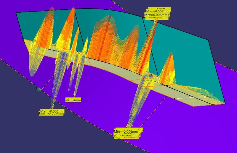

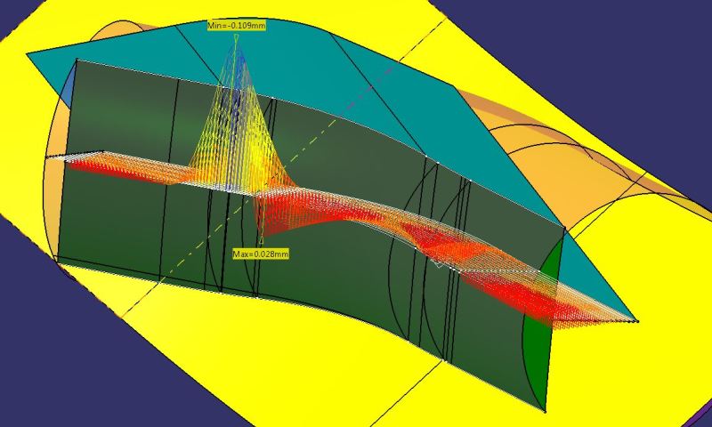

I built the surface (in green) explained by weavedreamer and use distance analysis with several intersection curves from offset surfaces.
Sometime we take shortcut for geometric understanding and the result might be within our tolerance and it's fine, as long as we understand the shortcut and we can validate the result.

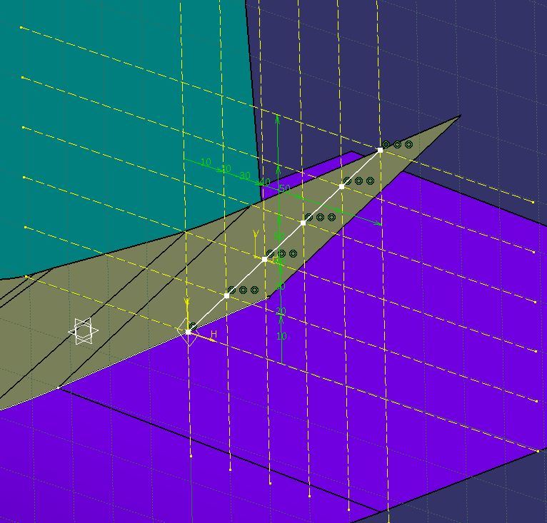

looking for an easy way to build this surface I used adaptive sweep.
in the sketch I made offset from surfaces and create points at intersection, then I have 1 spline joining all points.
As the sketch is swept along the spine, the offset curve will adapt to geometry and the spline will too.
Always check your results:
.007 away from intersection curve from offset...
I barely used this function but I am glad each time I find a good use for it.
Eric N.

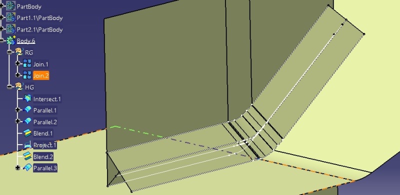

weavedreamer, I like your way the most. I tried it (a little bit modified) and it gives proper result. I'm presenting my way below.
itsmyjob, the measures on my drawing were angles between surfaces - at the beginning they were 90 deg. angled. Later, as a result of bent, the angle changes to ~80 deg. I'm explaining what I really wanted to achieve at the end of this post. It was just the beginning :D I tried your way with adaptive swept. However, it didn't work for me. I believe that the reason was small "bending radius" of mu surfaces. Adaptive swept just could not handle that. Perhaps I did something wrong. If you could present step by step how you guide and sketch looks that would be helpful.
Final way:
1. Intersection between two surfaces.
2. Two parallel curves, each 20mm away from intersection. I used two given surfaces as support for them.
3. Area between two parallel curves was blended.
4. Intersection projected on surface from point 3.
5. Intersection blended with projection.
6. Curve parallel to intersection from point 1, away 10mm.

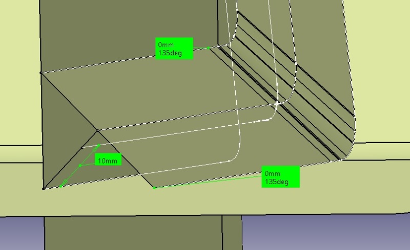

Actually, my problem is a little bit more advanced.
I need to make a fillet between two parts and it should have constant height, even when the angle between surfaces (like in my first post in this thread) changes as it goes along the intersection. How to create surface going through last curve I created in point 6 above AND keep the angle between this surface and two given surfaces equal on both sides?
Above you can see the surface used for bisector generation. Hovewer, it was generated by parallel curves 20mm away along two given surfaces. What I need is to be able to control height of this "traingle", so somehow I need to offset surface on the top to intersect parallel curve 10mm away from intersection.1.

I define my adaptive sweep sketch as this:
  • I create the intersect curve named I (just like you in 1)
  • I create a point P1 on I at ratio .5 from extremity
  • I create plane normal Pn to I on P1
  • I create a sketch S on Pn
  • in sketch S I turn the standard option for construction
  • I create intersection from both surface (gives me result in dashed lines)
  • I make offset from each curves (with instances 5)
  • I create points at desired intersection
  • I switch option back to standard mode
  • I create spline on points
Eric N.
