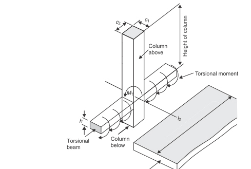

Hi structural87,
I think to effectively transfer the torsion from the slab to the column we will need a U-bar to wrap around the slab edge, a round link like beam stirrups will actually be better.
If you draw STM model with 3D truss representing the slab edge (see below) its apparent why we need to have a U-bar to transfer the torsion.

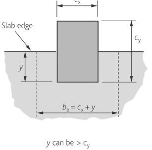

There's an ACI document that deals with slab/column joints. I believe that document recommends an effective width, based on joint geometry, over which your top steel beyond the column may be considered effective.
While I understand the logic behind u-bars, I've yet to see that recommended or executed in practice. I suspect that many contractors would deem the u-bars less constructible than conventional detailing. My experience may only be valid in my market of course.
The usual model for design is not to treat the slab edge as a torsion member but, rather, as the tension flange of a pseudo T-beam with a compression block of a width equal to the column face. The relevant strut and tie model pertains to the lateral spread of the compression block force out to the tension steel adjacent to the column.
This jives with the effective width concept and crests a demand for a tie force parallel to the slab edge that could be satisfied with edge bars, as mentioned above or compression in the slab edge between columns. If the column is in close proximity to the slab edge, there is usually ample top steel available for this purpose in the column top mat.
As for the development length in the top bars, that's a bit nebulous. Technically, it would be dictated by the STM model mentioned above. In practice, however, that STM model is rarely checked explicitly. My recommendation would be to:

Definitely U bars around the edge. I would extend the legs a full lap length past the face of the column at least. And make sure they get corner bars in the correct position and continuous through he column reinforcement.
