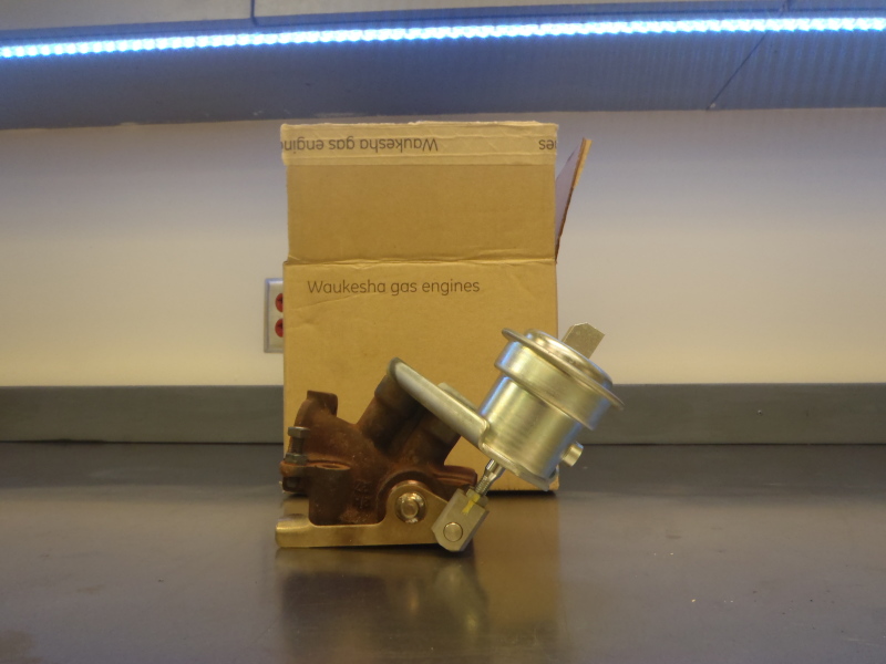

Hi guys,
Im running a couple VGF H24GLDs one of them was recently serviced, new head gaskets, wastegate, plugs, coils, oil ect.
but now I seem to have lost power in the engine. It bogs down and won't maintain speed at 500 amps while it it rated at 616 amps. (throttle fully open)
I have checked my O2, gas over air pressure, timing, firing, air intake and filters, compression and valve lash. I have checked for air leaks and exhaust leaks and I have little to no pressure drop from leaving the turbo to the Intake manifold and I am now out of ideas of what could be wrong
Compared to logs from before the service and last year, I seem to have about 5-6 psi lower intake manifold pressure at the same load.
I am suspecting maybe there is something wrong with the wastegate? despite it being new and not adjustable (like the old ones)
Any ideas?
Thanks in advance!
Dan

-(Update)-
The wastegate is not stuck open, just checked, it seems to open up when right after the heavy load has been applied and is evening out. But at around 10 PSI it opens (not fully) and at that point
too much exhaust is bypassed so I don't get sufficient boost in the intake to run at a higher load.
So I took out the new wastegate and had it laying next to my old wastegate, I hooked up some low pressure air, and I see that on the new wastegate it is very willing to open up, while on my Old
wastegate it takes about twice the psi before it moves. So I installed the old wastegate again and the engine runs just fine, even at almost max load, I have great boost and all is happy and dandy.
So seemingly the old wastegate works fine while the new one doesn't? they should be the same models.. unless there is a different wastegate for the G's, GL's or VHPs which is more sensitive?

Nope, Not adjustable. There is, however, a limit screw that will limit the valve from opening. But I don't feel like playing around with that. I don't want my generator to overshoot the speed during load changes because the turbo don't react fast enough.

RE: Waukesha VGF H24 GLD Bogging down under load
Is it this type of wastegate?
If so, does the "old" and "new" have the same number of spacers?
If so, there were about 5 different internal spring groups for these, three single spring and two double spring. They all look similar, and ran into a number of problems with wastegates when customers used aftermarket suppliers that built both CAT and Waukesha wastegates, springs, internal shims and spacers would get mixed up.
There was a shop in Midland TX that used to rebuild and supply new assemblies and parts, can't find their info anymore (been quite a while since I directly dealt with that stuff).
I don't either CAT or Waukesha ever published actual bench testing specs for wastegates, we used to take a known good wastegate for an application, then apply air pressure to the inlet in 2 PSI increments and measure the valve position with a depth mic, then record it on a spreadsheet. A shop I worked with many years ago (now closed and everyone moved on) had built a test bench with a long reach dial indicator and built up their own test sheets.
Hope that helps, MikeL.

No, doesn't look anywhere near those. I'll get a picture later on tonight. You'll know when you see it, nothing can really be done to ones I have.
Good idea about making that sheet with the measurements, no I just need a pressure regulator that is precise enough to actually read such small increments. I really only have centralized air in my shop.
I think Turbonetics make these for Waukesha, probably an OEM product but you might get someone there to give you some ideas.
One thing to look at on this style is the rod adjustment. You can affect the opening pressure by stacking gaskets (not recommended) or readjusting the rod if you can.
The flapper looks like it is seating evenly, how does it mating surface look?
If it was me I'd get a small air regulator and a good gauge and see how much stroke you get for a given range of pressures and compare. If they have gone to a "fixed" wastegate then to meet differing power and emissions ratings and altitude they would need to offer more than one. I know the local Waukesha guys are griping because after being bought by GE they are going thru a number of pains with parts supplies, differing distribution paths and apparently lots of old documentation disappearing as systems are "updated".
Your best bet may be to find a shop in the patch that has a good turbo guy who may be able to get you some better help.

Gruntguru; I'll have to get with the factory or something for the pressure spec. I don't find it in the manual nor does my rep know. I wouldn't necessarily want to modify the boost setting myself. I think i might then move into an area that's a bit over my head. I like your idea about the Bleed tee. I'll look into that, Thanks a bunch.
Catserveng (Mike) ; The rod is adjustable, according to the manual I have, Im only really "supposed" to change it because of altitude differences. and only by .04 of an inch per 1000 Meter elevation.
The mating surface is clean and smooth, the flapper sits fine. Yeah, I'll have to do the comparison over the weekend when the engine off.
Yes, Wrong wastegate, I put the old one back in and it worked fine. My question is now, I dont see any other part numbers for other wastegates, and I cant adjust this type. so
how can i have ended up with a wrong one?

The wastegate Part Number your tech provided is correct, that is what I ordered, and that is on the invoice too. However, if you read ealier as well
I had the old wastegate out laying next to the new one I hooked up compressed air to them both, and I saw that the "new" wastegate would open at a significantly smaller psi then the "old" one - Obviously then bypassing exhaust at a lower load.
So I put the old one back in, and my problems stopped. Engine running at rated load with no problems.. O2 readings are perfect too.. So it must be the new wastegate. I just cant figure out why? as I said, it is new?
As far as I know, I cant adjust the wastegate aside for the few 0.001" on the power piston for altitude adjustments - which by the way is exactly like the old one.
Dont really know what to do about it. It feels like $1900 down the drain. ( I know, I know... spare parts.. but yeah..)

I would pursue your warranty replacement options with the new wastegate. Evidently it is defective.
