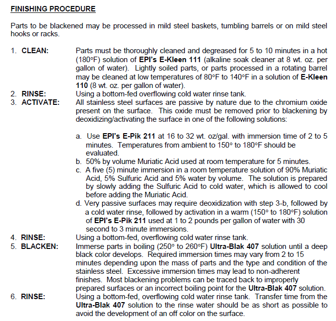

I have some parts made from 17-4PH cond H1025 stainless steel that require a black surface finish for cosmetic purposes only. I have been using MIL-DTL-13924 class 4 black oxide, but this black oxide coating is very easy to damage. I appreciate that black oxide coating is not intended to provide corrosion protection or wear resistance, but this black oxide comes off just from the rubbing contact experienced during routine handling. I did a comparison test with the black oxide coating on some commercial alloy steel fasteners I had. I rubbed both samples with fine steel wool (dry) and the black oxide coating on the fasteners was significantly more durable than the black oxide on my stainless parts.
Can anyone think of a reason for this situation? Am I using the proper type of black oxide process for my 17-4PH material? Or does this particular type of black oxide just have very poor durability?

I remember your previous thread on this subject (thread723-366531: Black Oxide Coating of Nitronic 60), and my second post mentioned an active surface. I believe that is your issue. For black oxide to work well, the stainless steel surface needs to be active. Here is one description of a preferred process:
To activate stainless steel before oxidizing requires a 50% sulfuric or hydrochloric acid solution. This activates the surface of the part and prepares the material surface to allow the black oxide to penetrate the stainless steel surface.
Talk to your supplier about activation prior to the black oxide immersion step. Good luck.

Take a look at Figure 11 in MIL-HDBK-205, especially the block called ACID PICKLE. That is the activation process.

A quick update. I've been continuing research with this black oxide on 17-4PH stainless problem. I found this company EPI which markets a proprietary black oxide process called Ultra-Blak 407 that conforms to MIL-DTL-13924 class 4. They sent the process instructions, and sure enough they describe a fairly detailed activation step just prior to oxidizing.
The process instructions also include this statement about excessive immersion time in the oxidizing solution causing non-adherence: "Required immersion times may vary from 2 to 15 minutes depending upon the mass of parts and the type and condition of the stainless steel. Excessive immersion times may lead to non-adherent finishes." So that's another thing I will have to check into.
