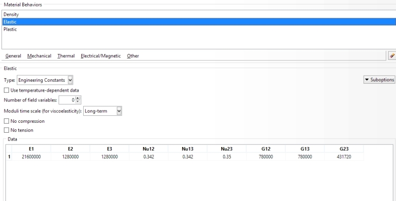

This is my material proprieties:
I don't know if it can help you.. I wonder on what I have to add an orientation...Sorry for my lack of knowledge I'm learning this alone..

RE: tie-Contact problems with Abaqus
Those material properties seem fine, but the material needs to have an orientation defined everywhere it is used. When you do your section assignments for each part or each partitioned region you will be in the "Property Module". This is where you need to assign the orientation of the material by doing...
In the Property Module go to Assign>>Material Orientation
Then follow the on screen commands to select which direction you want the material to be oriented. Then little triads will be placed on the model indicating the material orientation. Again this has to be done everywhere an anisotropic material is assigned.
I would also suggest making a copy of the model with the material being isotropic so that you can work on solving your tie-constraint problem while also working on the material orientation problem.
