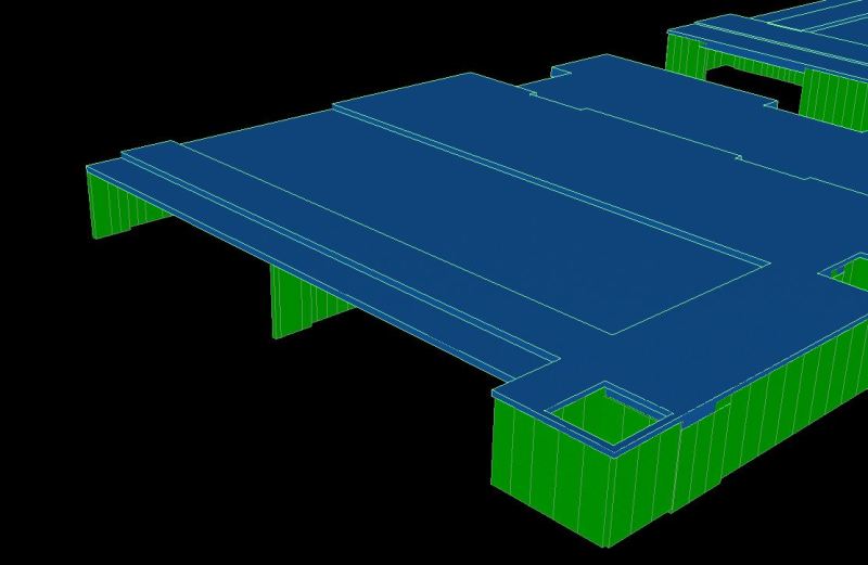

When have you guys ever reduced Vuc to 0 by adopting the following clause?
My situation: compatibility torsion on an internal T beam, from elastic uncracked analysis, is higher than 0.25PhiTuc and thus requires transverse steel to resist this torsion.
Now this torsion could potentially cause cracks (45 deg to long. axis) in the compression zone of the section and thus why I'm wondering whether to ignore the concrete contribution in shear?
Ignoring this moment and assuming cracking/redistribution of load to the adjacent slabs has occurred also leads me to believe that Vuc should be 0.

Designing the beam to the torsion section of the code results in double the shear density (Asv/s) required as opposed to the converting the torsion moment into a shear across the web of the beam.
In a 2400 x 500 beam, the total loss of Vuc is very significant. My engineering judgement (very green) tells me this beam does not need 6 legs of N12 @ 100 c/c.

Yeah, I've ended up designing the beams such that the torsion is added to the shear force. (This is in RAM, "as shear" option). I have modelled the beams without any torsional stiffness, but I think I'll still provide minimum torsion ties.
It's just when RAM sees torsion greater than min reo it automatically takes Vuc = 0. I emailed one of the senior directors who looks after Concept and he explained it quite well.
I'm assuming the transverse shear leg spacing rule of D or 600 won't apply to the torsion clauses, as the outer "loop" will do all the work. Thoughts? Providing 6 legs every 300mm seems overkill.
Just for completeness the beam in question is shown below.
