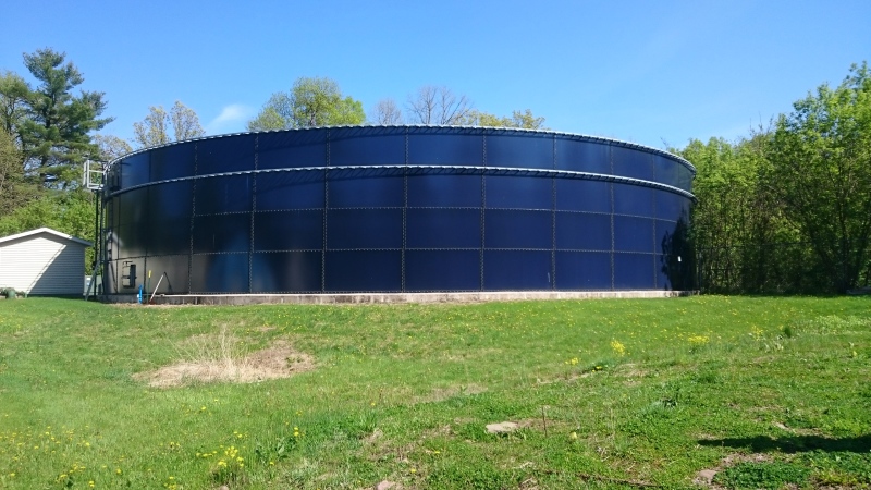

Wind girders are usually formed by welding an angle or a channel around the top edge of the shell. At the top of an open tank (or one with a floating roof), circumferential stiffening is needed to maintain the roundness of the tank when it is subject to wind load. This stiffening is particularly necessary when the tank is empty.

primary wind girder:
stiffening assembly ring located near the top of the shell course of open top floating roof tanks. Maintains roundness when the tank is subjected to wind loads.
secondary wind girder:
increased tank height, resulting in specific portions of unstiffened shell may require adding of a small annular ring at some lower elevation than the primary wind girder

Couple more pictures of a tank that I observed today that show the primary and secondary wind girders.
