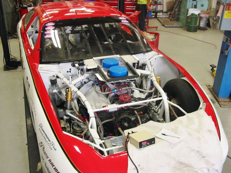

A friends race car engine has a dry oil sump and he wanted me to built a "babysitter" temperature controller for the tank to keep the temperature up between runs. I bought a cheap PID controller to drive a SSR into two 500W heaters. Initial test was with 4 gallons of oil using factory settings on the controller just to see how long it took to warm up and if the heaters boiled the oil. It took about 40 minutes and temperature would overshoot about 9 degrees, P=3, I=240 D=off. Thermally it is complicated. Sensor measures skin of the tank which is 18 degrees colder than the 180F of the oil and it is located close to one of the two heaters. The tank is heavily baffled. The good part is it only has to compensate for thermal loss of the uninsulated tank, about 5 minutes per degree drop.
I was convinced the miracle software of auto tune would get this to a fraction of a degree. A few days later auto tune came up with P=.9 I=276 D=69. Don't remember exact overshoot, but it seemed large and it was clear it would never be stable. From what I had gleaned the numbers should be lower with a large thermal mass, D wasn't used that often and from first test that a large I seemed to be a problem. Better to deal with just two variables. Just plain ran out of time and final numbers were P=.8 I=36 D=off. It will drop 1 degree below set point and overshoot two degrees. Bothered that at 1 degree over set it is still proportionally pumping in some heat.
They are thrilled at how it works as their main concern is boiling the oil. This is my first experience with a PID temperature controller. For me auto tune was a great disappointment. Just playing with the numbers took hours and there appeared no obvious correlation between stability and overshoot. I probably only get one more shot at this till next November. If I could have charted it out, the numbers might have made some sense. From your experience, what would be the number to change the next time and are there general rules?

RE: PID temperature control
My interest is almost purely academic. This tank will only operate only about minutes between races and will unlikely ever reach stability due to long thermal lag. I think it works quite well for an $18 controller, but I think it doesn't has enough bits to make really good decisions. It has an undocumented screen that displays duty cycle. When stable it is approximately 25% or a heat loss of about 250W.
I understand the theory, in practice it is quite a time waster. Just looking for a practical way to get to the values as quickly as possible. Data recording was inconsistent and changes weren't obvious. Without running something like a chart recorder it is hard to see changes when the thermal lag is so long. There have to be some tricks to get values faster. Saying turn up P as high as you can get it gives some insight, but what characteristic says too much. That can
only come with observing the system. I have a FUJI PXW series that will be bread-boarded with an aluminum bar with less thermal lag as a trainer when I get some time. I'm three weeks from leaving to my summer place for five months that is totally off grid, the wife has me painting the house now and I just cut down five trees yesterday that will take a week to dispose of. The oil heater is a done deal, at least till maybe they make the 4 inch deep aluminum pipe plug for the sensor this winter.
The center of the tank measures a fairly stable 180 degrees measured with a long probe. Their gold standard is a liquid filled water temperature gauge. Just knowing that others have a low opinion of auto tune has been helpful. Looking forward to playing around with the test fixture and gaining some experience. I have been unsuccessful in explaining my core thoughts. Honestly, the apparently good results were made with almost random values and I find that disturbing.

Suggestions:
Temperature sensor location.
Issues: The lowest temperature is important. You don't want a slug of oil below the desired temperature entering the lubrication stream from a section of the tank that has not reached the proper temperature due to the baffles.
Highest temperature. You don't want the oil boiling or fractionating off the lighter fractions.
Heat sources. You may consider adding more heaters.
A circulating pump, properly applied, may go far to mitigating uneven temperatures.
Any other suggestions as to how to arrange the system so that we are actually controlling the temperature of the oil directly and mitigating issues with uneven heating?
