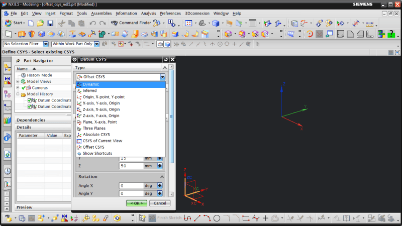

Hi
We use a few thousand offset Datum CSYS features in our designs to primarily control hole positions of complex fluid networks, thus it is very important to us that we can quickly and accurately move them around.
Our standard method in NX 7.5 and NX 8.5 was to change the Datum CSYS feature type from offset CSYS to dynamic, move the CSYS to the new positon and then change it back to offset CSYS. This has worked very well especially compared to the work flow in I-deas where we first had to measure and then modify the offset values.
But in NX9 this method has stopped working as the selected reference CSYS is lost when changing the type of the Datum CSYS feature from offset to Dynamic. We have contacted GTAC about this issue (PR 8252994) but have heard nothing for 7 months. I suspect that this is a minor UI issue relating to the update method for the Datum CSYS dialog, but with major consequences for my design department.
My questions to eng-tips are;
  • Is this behavior present in NX 10?
  • Anybody got ideas for a workaround?
Below follows a step by step example first of the desired behavior in NX8.5 and then the undesired behavior in NX9, I have also attached movies showcasing the same in NX7.5, 8.5 and 9.0.

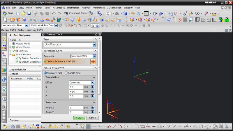

NX 8.5 Step 01 - CSYS Feature that is offset from another Datum CSYS in ABS zero.
NX 8.5 Step 02 - Editing the datum CSYS feature and changing type from Offset to Dynamic to quickly move it.
NX 8.5 Step 03 - Moving the Datum CSYS with the dynamic CSYS tool.
NX 8.5 Step 04 - Changing the type back to offset keeps the reference to the ABS datum CSYS feature.

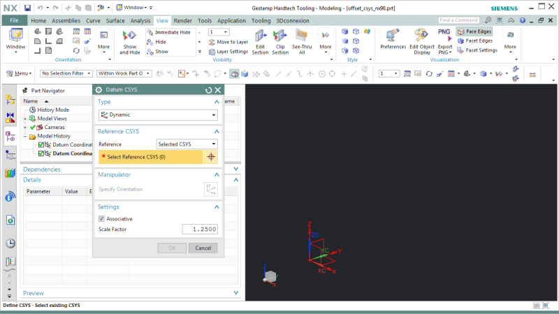

NX 9 Step 01 - Same Setup as in NX 8.5 Step 01.
NX 9 Step 02 - Editing the offset Datum CSYS feature.
NX 9 Step 03 - Changing the type from offset to dynamic resets the Reference CSYS selection and it is not possible to quickly move the offset CSYS. Selecting a new reference CSYS and all offset values are lost.
I have performed the same test in the following NX versions
NX 7.5.5.4 MP9 - No problem
NX 8.5.3.3 - No Problem
NX 9.0.3.4 MP6 - Problem is present in all N9 Releases
RE: NX 9 Problem with Datum CSYS feature
It appears that NX 10.0.0.24 behaves the same as NX 9.

John: Thanks Did not even reflect on the Priority level, I have contacted our Siemens reseller that were the ones that opened the PR and have asked them to contact GTAC and request an upgrade of the priority.
Cowski: Thanks a lot! Very clever and simple approach.
OK, I've got an update on the status of this PR. It has been fixed and will be part of NX 10.0.3.x, which will be released later in the year.
