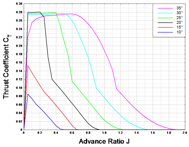

this is an example of 4 blade propeller with a diameter of 4 meter.
For my application the advance ratio is between zero and 0.35 if i consider the maximum speed at tip with mach 0.75.
how you can see the thrust is good but the efficiency don't reach the 60% .
I can increase it with a three blade propeller and with a small diameter but still i can have only 65% in the best case and at lower speed than 30 m/s
the efficiency is very low.
It's possible have this value ?

lets see if I understand your plots right ...
the green plot says that for a J = 0.3, CT = 0.28, so you can calc the thrust produced; and eff = 0.45, so you can calc the installed engine power (req'd to produce the thrust, and Thrust*V = propulsive power). yes?
for my money, just from looking at these plots, black looks to be the best compromise.
does your engine have only one operating speed ? variable pitch propellers change pitch to allow the propeller to work at a higher aerodynamic efficiency over different speed ranges (a fixed pitch prop is designed for maximum efficiency at one speed (aircraft speed, that is) and pretty much sucks at any other. The "normal" design would be to have the engine working away at it's preferred design speed (rotational, that is) and have a gearbox to change the propeller speed.
