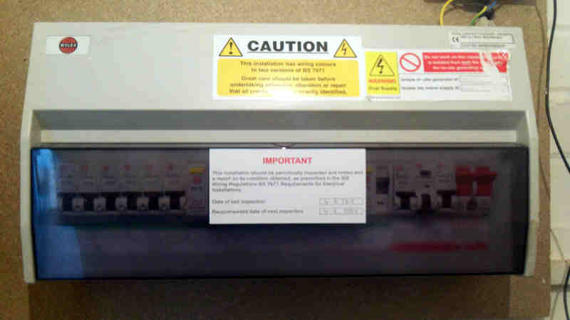

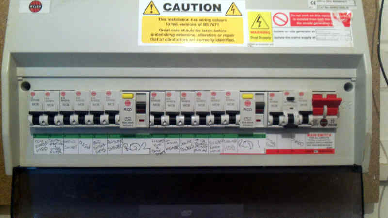

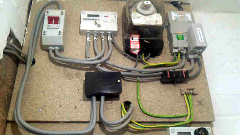

We are assuming that this is a PME installation with a combined neutral and earth conductor. If it is a remote installation then there's a strong possibility that this is a TT system rather than a TNC-S system.
Can you take a photograph of the electrity meter, consumer unit, and the incoming cable from the utility and post it on here? Do you have the inspection & test sheets from the rewire? One on of the sheets - second one i think - there should be a few tick-boxes for supply sharacteristics. Post a photo of that sheet too. Can you tell if there's an earth rod near the intake? Does your supply come in on an overhead line?

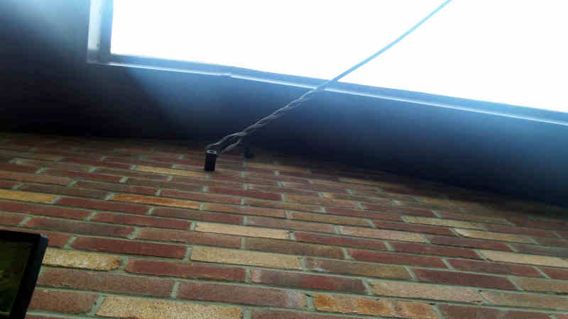

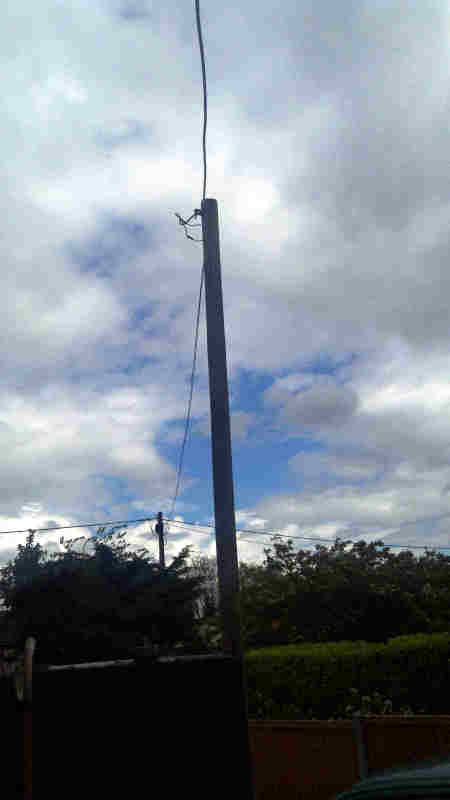

'ScottyUK' : sure, here are the images you have requested. we also have solar panels on the roof, so some of the boxes on the board relate to those. the incoming cable is an overhead one:
http://files.engineering.com/download.aspx?folder=...
RE: challenging problem with pro audio music keyboard (USB) - possibly related to earthing of house
It certainly looks like you have a TNC-S system so you're reliant upon the utility for ensuring that the neutral point of the source is connected to the mass of earth. The neutral and earth share a single conductor up to the service fuse in the grey block at the top right of your installation, and at that point they separate. The neutral/earth conductor is connected to the mass of earth at the utility's transformer, but it's not impossible for the utility's earth connection to be bad. You could consider adding an earth rod or two and connecting them to the earth block on the installation to see if that improves the behaviour of your equipment. If it does make a difference then you need to ask the utility to address the problem with their installation.
ok, yes, i think you are correct. so i looked at the small junction block at the bottom-right of the mounting board and see that there is an empty connector there.. is that the spot that i would plug in an earthing rod?
my dad had the idea to connect the earth pin of the plug from one of my computer's psu cables to a grounding point, such as a bare metal area of a radiator pipe in the house, to test the idea of improving the grounding to the computer
- rather than going and buying grounding rods and messing with the main electrical block; does that sound like a wise move here? or is there a reason why a grounding rod or two might give a much better result?

I'm suggesting that you undertake a trial by improving the connection between your building earthing system - the green & yellow wires - and the mass of earth itself. The only way to do that is using a metallic rod or object buried in the ground. Rods are easy and cheap, but copper mats and cast-iron grids were used in the past. Leave the radiators alone! You have the correct connection point I think - where all the other green & yellow wiring meets. You will need a decent-size cable to the rod.s
