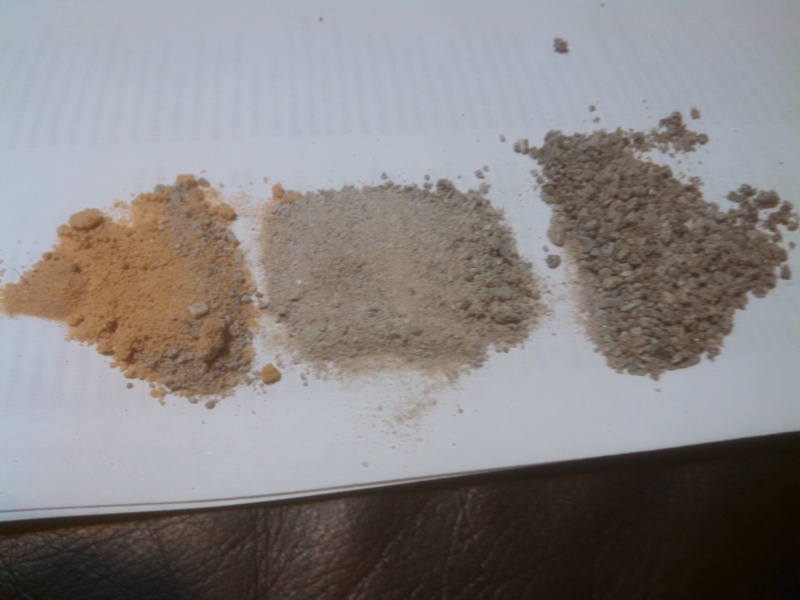

I have included a picture of the local sands the I have found available. From left, play sand is a no as it is round and does not interlock and I understand lime base sand is not good. The middle product is rated c-33, but seems very fine if not powdery. On the right is paver sand, which is very course. I have looked at each under 100X. Are you recommending the ASTM C-33 even though it seems silty? (package claims it is washed but under 100X it seems to have what look like salts attached to the jagged bits of rock).

As to your samples, the right hand one may be OK, but without really sieving the samples I can't say much. If the sources say their sand meets ASTM C-33 fine aggregate, that should be sufficient. It runs between 3/8"-#4 sieve and just above the #200 sieve.
The figures in that part of the publication have the general rules for particle sizes for graded filters that can be applied to many situations, such as drainage from within earth dams to pavement base drainage.
