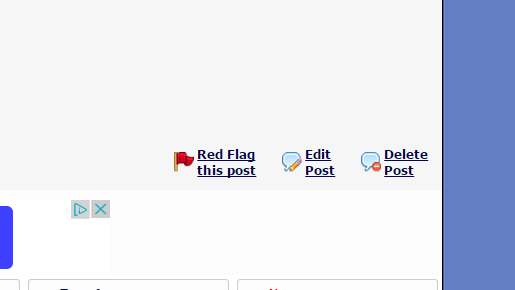

Please note that you can now edit (as well as delete), for a period of 24 hours, any of your OWN posts, so you could have gone back and added your missing attachment. After posting a response and you discover something that you wish to correct, just look for the 'Edit' and 'Delete' options in the lower Right corner of your post, as shown below:
Note that this is a new feature added to Eng-Tips in the past week or so. But note that there will be a 'paper trail' showing what it is that you edited so you can't use this tool to 'rewrite history' as it were.
