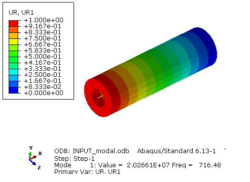

The fact is that I simulate the pipe with a beam (B31) element. One side is clamped and the other one is only able to rotate arround its longitudinal axis. The torsional stiffness and the inertia that I obtain match with analytical values. But when I run the modal analysis I get that:
Eigenvalue = 2.02661E+07. Then, Frequency = 4501 rad/s = 716.48Hz
So, the eigenvalue in the FEM is exactly twice the analytical one. ¿What am I doing wrong? ¿Does this make any sense?

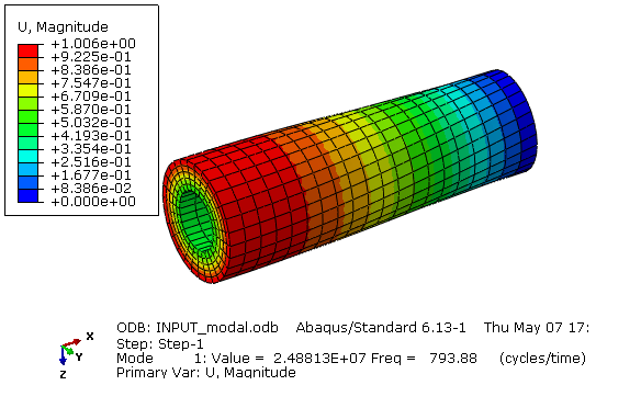

I have also tried to model the thick pipe with solid elemenets (C3D20R) and I get the similar result to B31 element.
