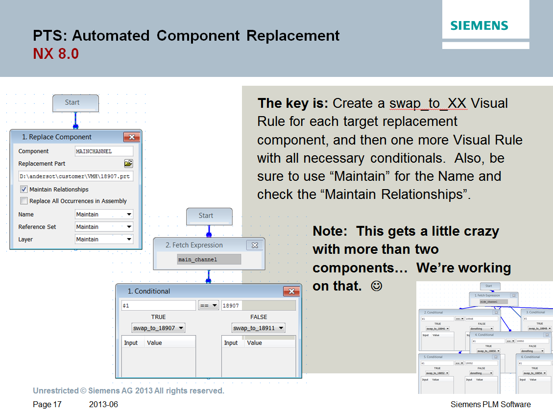

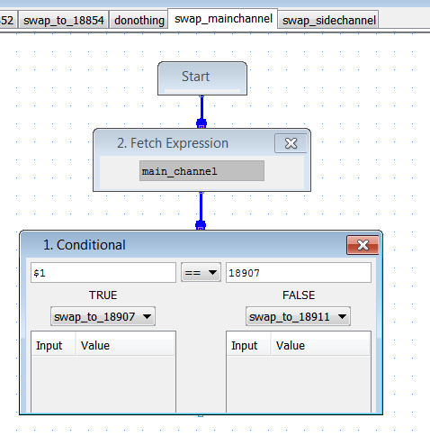

The key is to have one Visual Rule containing the logic, which then calls one Visual Rule for each actual replacement action. Here's a slide from a 2013 PLM World "PTS 201" presentation I gave about slightly more advanced PTS topics:
For a two-part swap, this might look like this, with one rule like this containing the logic:

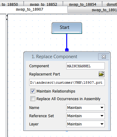

And one rule like this driving each specific replacement:
_________

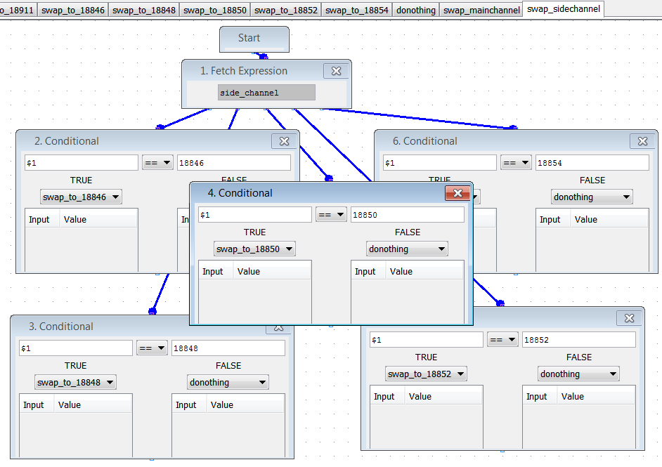

For a larger swap involving five components, for instance, the individual rules would look just like the two above, while the logic rule might look more like this:
There is some basic training for Visual Rules is in the Learning Advantage course for PTS, but in a nutshell, you'll drag rules from the palette on the left into the workspace, string them together with arrows, and fill out the forms. smile

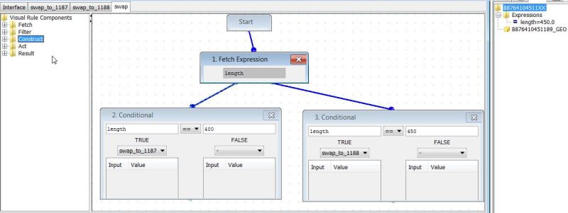

But there is one think I didn't understand. Could you please show me how your Interface with the expression look like?
Is "$1" the name of the expression?
Cause the name of my expression is for example "lenght"
Fetch Expression --> "length"
2. Conditional: "length" = 500
Is there any way to check the rule while working in PTS?
"MAINCHANNEL" is the name of the component you want to replace?
Thank you so much.
RE: PTS - replace component
maybe that screenshot will help you to find my mistake.

The $1 is whatever is coming in the arrow from the previous block. smile
What's happening here is that the Conditional block is more generic than you're thinking. More to the point, It's not specifically looking for an expression, and so it's not recognizing "length" as an expression name.
Using the $1 ensures that the expression "length" is what gets passed into the conditional, as opposed to just the random string "length". (Does that make sense?)
This conditional block can be used for lots of things besides expressions. For example you might create a rule that counts the number of holes in a body, and then decides to either do or not do something based on that quantity. The number of holes doesn't have to be an expression at all. If it was calculated in the previous block and passed in with an arrow, then the $1 will pick it up and use it.

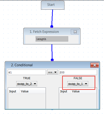

1. In your Visual Rules, you had created your "swap_to_2" rule perfectly, and had correctly selected that rule as the action for the TRUE branch in your "swap" rule. But your FALSE branch didn't have anything to do. I added a "swap_to_1" rule just like your "swap_to_2" rule (though referring to the other part, of course), and selected it for the FALSE branch:

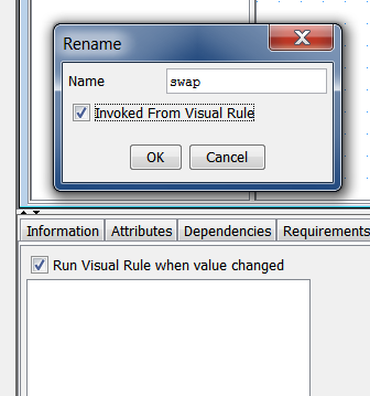

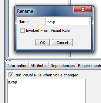

2. While you had indeed checked "Run Visual Rule when value changed" for the Expression "length", you'd not selected you "swap" rule there... But I see why. smile [You couldn't see it there.]
When creating the "swap" rule, you'd checked the little "Invoked From Visual Rule" box. This check indicates that the rule is going to be invoked only from other Visual Rules, and not invoked directly from the UI. In your example, your "swap_to_1" and "swap_to_2" rules are exactly this, and should have this checked, because each of them will only be used from the context of your conditional "swap" rule.
But because you want your "length" expression to invoke your main "swap" rule, this should not be checked. With this checked, your "swap" rule was not visible in the list of available rules in your "length" expression:
Unchecking this for the "swap" rule makes it visible there:
...and so...
3. At that point you can then SELECT your "swap" rule, and you're off to the races. smile

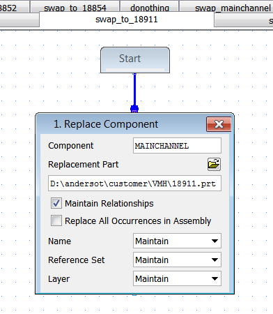

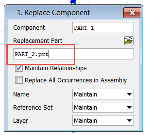

4. The last one is a stylistic thing, but I also removed the file paths from the Replace Component blocks, like this:
This just helps with portability, if the template location moves around on disk (like when you send it to me, and when I send it back to you.)
