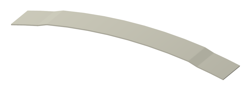

I'm assuming the ID plate is made of an alloy that readily resistance welds to the Inconel used for the casing. As others suggested it would help to use a thinner plate material that is less stiff, or to use a pattern of welds that is less constraining under thermal expansion conditions.
Of course, you could also make a custom Inconel sheet metal ID plate that has a joggle formed somewhere between the weld locations to serve as a strain relief/expansion joint.

roberto1brazil-
Here's a quick sketch of how you can modify your existing ID plate with two brake formed joggles to provide some strain relief between the welds at each end.

Hello dvd and tbuelna. Just for information, the plate is made of stainles steel series 300. I believe that your suggestion is something easy to do. Ok, we will test this configuration of plate on the turbine casing.
Thanks and best regards
