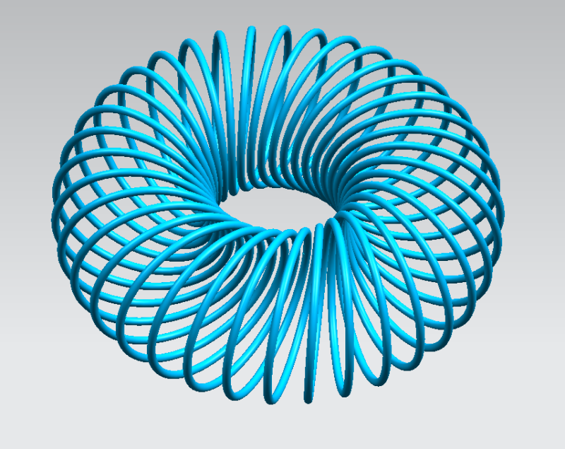

Using NX 6.0, the attached is about as good as I can get it. Not that it's not really all that parametric, but it at least looks right. Here's a picture of what I got:

RE: Slant (canted) coil spring
John,
Excellent, this is exactly what I asked for... however I apparently had bad examples.
Is it possible to adjust the slant in another direction? I'll attach some pictures of a sample spring I have, I hope it helps.
http://files.engineering.com/getfile.aspx?folder=3...
Also,
I see your helix was made with a law for the radius method. is it possible to edit the values in this law? I don't see them in expressions...
Forever grateful,
Ryan
Yes, the law values can be Expressions. That being said, if you wanted a true, fully parametric model, particularly using something as old as NX 6.0, it would not be a trivial exercise.
The approach I took was purely for the visual effect. I only modeled what would look close to what you were looking for, just as a sort of, "Yes, NX can make models that look like this."
As for whether it might be a bit easier in NX 8.5 or newer version, yes that might be true. Could you provide some specifications as the size, angle, number of loops, etc that you're looking for?
I used the Move Object with the Copy Original option that allowed me to make multiple copies of the single look Helical curve. Of course, that means that there's no feature being created, as I alluded to when I said that it was "not really all that parametric". Perhaps with the current version of NX things could be more associative and feature-line.

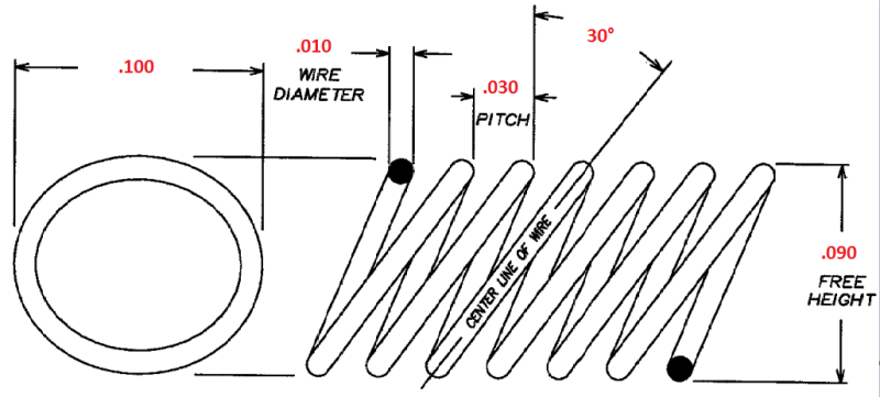

Gents,
Some generic spring numbers below. Units are in inches, length of spring in my pic is ~7.5" so diameter roughly 2 3/8".
Thanks,
Ryan
a984928 : Wow! That's a nice one !
Regards,
Tomas
Nice model A984928! This will come in very handy for me, THANKS!
a984928: VERY nicely done. Including the elliptic parameters was a great move.
