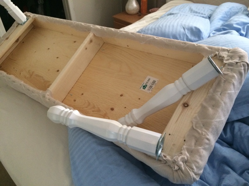

I'm fine with designing decks as free standing so long as consideration is given to stability and connection flexibility. I feel that it is inherently riskier than attaching to the house however.
My wife built us a little bench for the end of our bed. See the photo below. The diaphragm was much stiffer than a free standing deck diaphragm and the moment connections at the top of the legs was probably about as stiff, relatively speaking. Yesterday I sat on it to adjust one of my shoelaces. The bench P-Delta'd over slow enough for me to perceive it but too fast for me to react and prevent my other foot from getting squished.

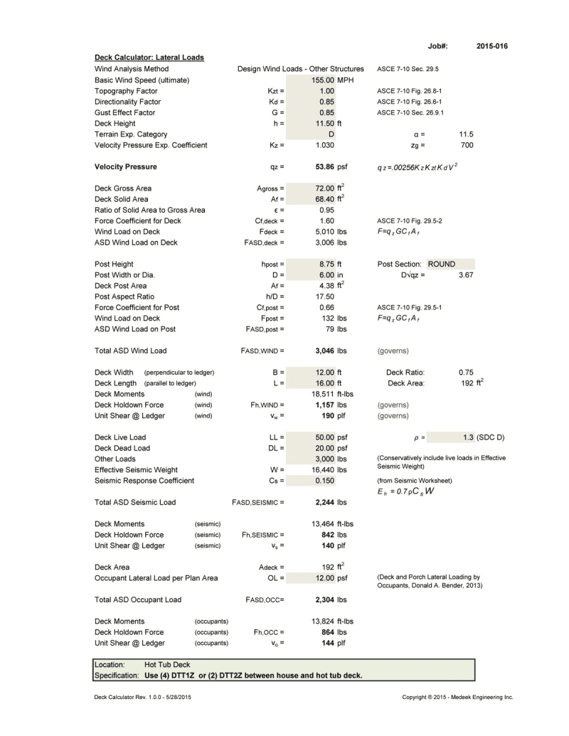

Based on the three papers listed above that deal specifically with lateral loads on decks I came up with the following spreadsheet:
In this case the wind load governs over the other two (seismic and occupants) due to the large (mostly solid) profile created by the double deck, the high basic wind speed and the exposure D (right on the beach). Otherwise the occupancy lateral load probably would control. Also note this particular deck has double the dead load due to two levels of decking and an additional 3000 lbs for a large hot tub as well as an increase in 10 psf per the owner's request.

I don't have ASCE in front of me. How did you get the gust factor of 0.85? Is that for a rigid structure?
RE: Residential Deck Engineering
Yes, the white paper went through the calculations to get the gust factor but then after all of the math stated a .85 gust factor would probably be appropriate per ASCE 7-10 Sec. 26.9.1 if we assume a rigid structure.
A copy of the spreadsheet is here for those who are interested in comparing the numbers to the white papers given above:
http://design.medeek.com/resources/deck/
The seismic analysis done by Bender's paper is slightly different that the methodology I used. His was more complicated due to the deck connecting to a 2nd story level. My calculator assumes a first story deck and a simple calculation. My approach may be incorrect.

As a licensed engineer, etc., I recommend that you consider gust effect factors for flexible structures.
R. Garner, S.E.
Based on ASCE 7-10 Sec. 12.8.2.1 the approx. fundamental period is .112 Sec. which translates to a fundamental frequency of 8.9 Hz.
According to ASCE 7-10 Sec. 26.2 if the fundamental frequency is greater than or equal to 1 Hz the structure can be assumed rigid and the gust effect factor can be assigned to 0.85.
