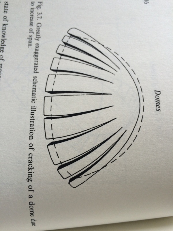

Just by visiualizing the deformed shape of the dome, it seams to me that any spread in the ring beam implies in plane flexural strain in the dome shell. The less rigid the ring beam is, the less dome like the behavior, right? I've always assumed that was why it's quite common to post tension large scale ring beams.
I recently read an account of how the Orange Peel hypothesis of cracked domes allows the St. Peter's dome to remain viable post spread (pic below). It's fascinating. To some degree, this redistribution of load will take place even in a reinforced dome as it transitions to the cracked state. I'm not suggesting that you should design your dome this way. This is just fun shop talk. You can take some comfort from knowing that this two way arch behaviour is available as a last resort however.
