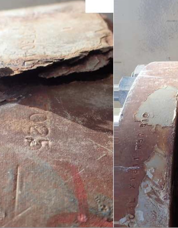

Dear all,
I have a few heat exchanger flanges found cracked possibly due to over-torqued and victim of hydrogen sulfide stress cracking, the operating temperature is between 45 to 129 deg C.
I can't shutdown the line for replacement, is there any ways to temporary repair these flanges and hold them for at least 1 year until next shutdown? Flange repair clamp sounds like a solution but I'm afraid it will further damage the flange during fastening..

You say you have "a few HX flanges" Are they all cracked like this?
For me I would simply clamp it with two half shells around the flange outer circumference.
I don't know what the crack mechanism here is, but SCC seems unlikely in this location. That would require some force to split that unless there is a material fault.
Seems a thick flange for 10 psi(a?) - is this under vacuum?
how far does that crack go? Picture from underneath would be good.
RE: Temporary Repair Cracked Flange
There all total of 4 flanges found cracked, the one that I showed in the photo is the most critical. We suspect due to over-torqued, we are actually taking over one of the oldest offshore gas platforms from another operator and there are a lot of rehab required, we don't even know why there are such defects at the first place after being handed-over the platform, we were not being handled over the inspection reports from the previous operator and now we have to start all over again.. :(
The crack goes quite deep and almost reaches the bolt..
If putting on 2-half-shell clamps or split sleeve repair clamps on the flanges, will it actually causing more stress to the cracks and eventually rupture the flange? My vendor could not give any better justification because not even them dare to give any warranty of at least 1 year.
Another concern is if putting on repair clamp, what will be the recommended tension/torque for the clamps' bolting? The clamp will be secured from outside the flange, over-torque will definitely causing more cracks on the flange, and insufficient torque will make no difference to the repair.. I don't prefer welding on the repair clamp because we need to frequently monitor the flange, and by bolting is able to tighten more flexibly..

As it seems from the stamping on the flange at your pictures, this NPS 12" RTJ flange is made of 304 stainless.
I wouldn’t consider the austenitic stainless steel (300 series) as the best choice for offshore environment……
Cl-SCC usually occurs at above 60°C (and more likely under wet insulation).

Bro shmulik, it is not SS304, SS304 definitely not be suitable in offshore.
You had a point just like MJCronin, CI will be the victom for such cracking occured, and yes it is under wet insulation (it is HX). I will have to check with the inspector once again because the inspection report is presenting it as CS.

SIMONMAGSUCANG, please recheck the stamping on the flange for the material:
[or "304L"?]

After checking with inspector once again, the cracked flanges are SS304, however the drawing was stated CS...

No, since these are SS with known chloride stress cracking you tell your boss that the only option is shutting them down for replacement now.
Anything that you do will shift stresses and result in new cracks.
You could make new split rings to put on the outside of both faces, but what about where the flange attaches to the body? Are there any cracks there?

This is no way to do failure analysis. You need to understand both the fracture mechanism and the root cause before contemplating a fix. In the meantime point a portable XRF instrument at the metal.
More significant than the grade stamped on the flange - what is the country of origin?

So far the cracks only be seen outside thw flange, the agenda is we might probably temporary shutdown the Glycol HX for a while in the next few days to have a full inspection, if it has cracks at the internal connection we will have to go for replacement of the flange which we have to go for higher authority to urge for pausing the production before worse thing happens.
If it doesn't crack at the internal connection, we might go for flange split repair clamp, and then find a suitable window to have it replaced in 3~6 months time rather than wait for the next shutdown (12 months).
