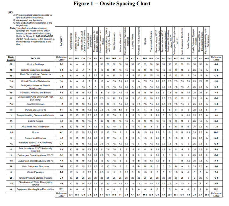

Is there a guideline (maybe from AGA) that provides requirements for the minimum distance between two compressor buildings so that they can still utilize the same ESD system? For example if there are 3 compressor buildings in the same facility, what is the minimum distance they can be from each other so that when one building ESD's, the other two can still be running?

Yes I am aware of that but we have determined that "station gas piping" is limited to the compressor building and the headers associated with that building, excluding yard piping. We have several sites where we implement this logic and the state public service commission understands this. My questions is what is the minimum distance the building have to be to prevent blowing down multiple building. I have seen a few insurance policies stating 350 ft but cannot seem to locate where that originates from.

Saudi Aramco's unit spacing guide,
Major Oil Company,

Can you tell me what book this is from? From what I can see here, the major oil company and Aramco states 3m for compressors? That is way too close...just 10 ft. The size of the building alone will be much larger. I was thinking around 100ft would work but I really have no basis for it.

In effect yes that's what I'm asking. Well an ESD vents all the gas from inside the building during a possible gas leak inside the building or a fire. The question is how far would an adjacent compressor building need to be for it to be considered safe to run. Now I understand depending on the pressure inside the building at the time the blast pressure could wipe out buildings next to it but the question is what would be considered safe.

I do but this is more of a question for a new facility being built. Is the one way to do this by calculating blast pressure? I realize this would be an accurate method...I guess I was just thinking there was some recommended practices when it came to this similar to what BigInch posted.
RE: Distance between compressor building
No. 3m is compressor, machine to machine minimum edge distance.
Building to building would be like G1 to A1, or B1, which is 30m, or 15.
I'd use 15m if the buildings are unoccupied (no continuous personnel duty station within), as a control building always is assumed to have people within 24-7. If you mean this to be more of a blast resistant structure, rather than just fire safe for a few hours, use 30m, or more.
You could check with your company's risk control department. Perhaps they have you insurance company's requirements on hand.

I don't understand why you want to have this same ESD system. I think what you mean is unit ESD trips. There is no reason why an individual compressor trip should necessarily cause an adjacent unit trip. If the reason for the ESD is a gas leak inside the compressor building that shouldn't affect the next one.
The issue over distance is really one of fire and explosion. If this is your concern then yes, 100m or so will take most adjacent buildings out of the way of jet fires or explosion, however you don't really want to be operating in those conditions, but might want to separate them to avoid damage. This however is highly unlikely and in most locations you don't have the space and it costs more to connect them all back to a single control room and the operators will get very fit walking between them cursing all the time about why these are so far away.
I would go for somewhere between 10 to 20m.
That's correct ESD compressor building trips...there would be 1-3 compressors in one building and 1-3 in another. I completely agree but I think we might stick to 30m just to be on the safe side and we have the room to do so.
