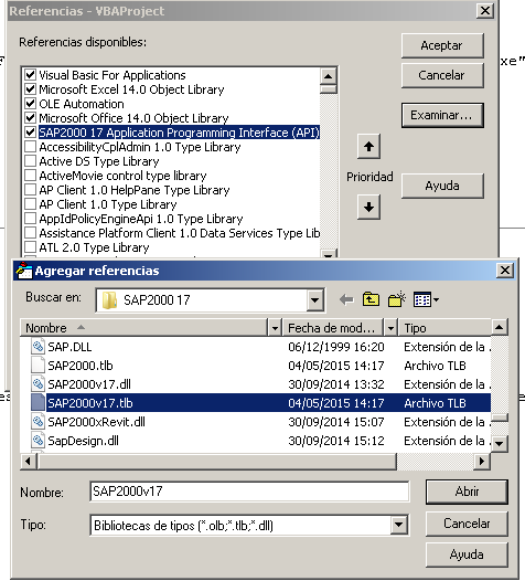

So, the first step that I did was add SAP2000v17.tlb file as a Excel VBA reference

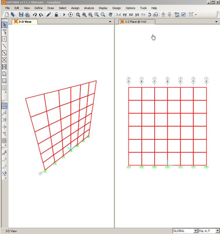

The second step is open a SDB file manually...I use a SDB created with the Template form built-in in SAP2000
