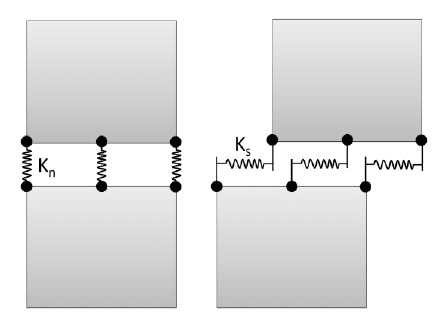

Hello everyone, I’m trying to apply connectors to represent the contact (mortar) between a beam and a wall (both represented in shell element). I need to apply two behaviors, axial and tangential, as presented in the image (1). I’m using a basic connector (slide-plane + align), that presents available CORM: U2, U3. When I enter with a negative value to the force F that means a compression to the connector right?
Image (1)
The greatest problem is due to the tangential behavior, I’m getting a undesired displacement between the two shell elements (Image 2). How can I solve this problem?
Image (2)
I’m reading about represent the contact as springs with determined stiffness, as presented in the image (3). How can I do it on abaqus? Can I use the connectors?
Image (3)
If anyone could give some tips, I would be glad.

Sounds for me like you used connectors to approximate a contact and you where getting an approximate solution.
Visualize your connectors, check their orientations in the deformed configuration and their forces and displacements.

Hi Mustaine3, could you help me check the orientation and the forces of the connectors? How can I do that? When I try to get the results (CTF) from the history output request I get the following message: Fastner domain data is missing.

Display connector CSYS: View > ODB Display Options > Entity Display > Show Connectors
"Fastner domain data is missing"
When does this message appear? Have you requested Connector History Output in Preprocessing?

Thanks Mustaine3, I'm doing a mistake during the selection of the set. So far,I could not find a solution for to my problem. I’m trying to define a contact that provide me as an axial behavior, a zero stiffness to positive deformation (traction), working only in compression. In addition, I am trying to find a good way to represent the stiffness behavior in tangential direction. Do you know how could I represent it?
What does that mean? No friction?

Sorry Mustaine3, I explain it in a poorly way.
I need that the axial behavior of my connector presents stiffness only to compression. When solicited by traction forces I want that the connector present a null stiffness. I try to represent this behavior with the first graphic. When solicited by an axial force of compression (negative), the connector present a small displacement, due to the stiffness of the connector. When the connector solicited by an axial force of traction (positive), the connecter present zero stiffness, so occur a big displacement. Do you think that this consideration is right?
