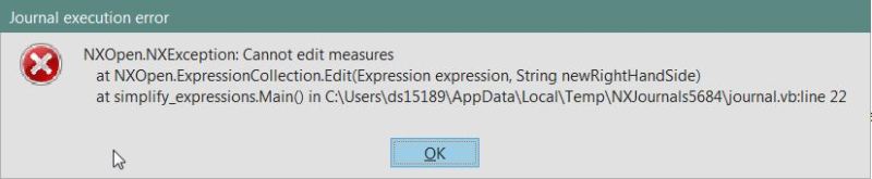

hey. thank you for your Response.
I get error Messages when I try to run the Journal.
Obviously it is because there a measures in the part. But I need them... is it possible to skip measures?
And I would like to have added a command to delete all user defined expressions afterwards.
RE: Deleting Expressions NX
The fix for the above error is in the thread you reference, post by petulf dated 30 May 12 18:17:
CODE
If exp.Type.Contains("Number") And Not exp.IsMeasurementExpression Then
    'process expression
Deleting all the user expressions will be a bit trickier. Differentiating between user expressions and system expressions may be difficult; a quick look through the API documentation didn't reveal a method to tell the difference. Also, if any feature directly references a user expression, the expression will not be able to be deleted until the dependency is broken.
