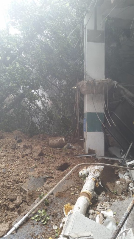

It appears that the partial multi-floor collapse was in the stand-alone public parking structure (that make up the large Watergate complex along with office, condo and hotel buildings) and from photos from CNN it does not appear to be PT flat plate construction.
Looked like some significant landscaping was being undertaken on the upper 'green' level at the time of collapse.

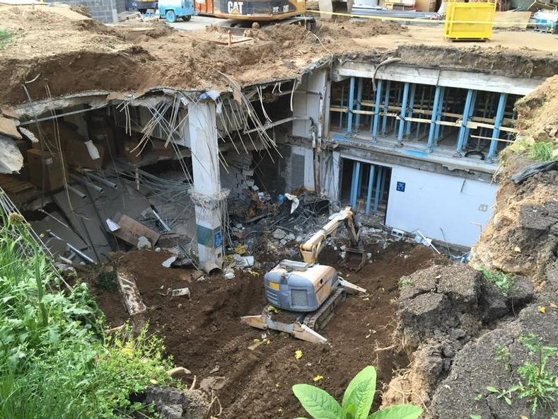

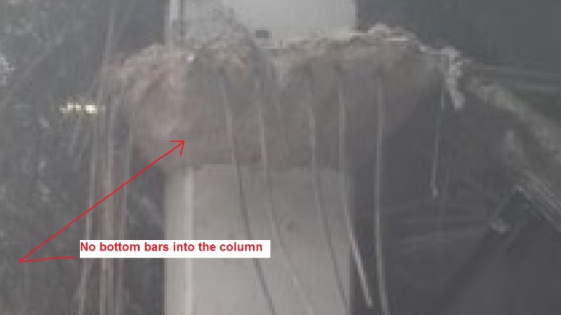

That's a good photo of a punching shear failure, and looks like a flat plate. I couldn't find photos that show much of the collapsed structure. There are some photos taken under the part which is adjacent, and that is a waffle plate.
RE: Collapse of carparking structure, Watergate, DC
Some of the photos show a portion of waffle which came down, but it is hard to tell whether that is the type structure which failed, or was taken out by debris from above.

Where are the bottom bars into the column? Usually ACI required 6" into the support.
With only 6" of embedment, they probably were pulled out when the slab fell. A better picture might show holes where the bars were.

Yes, the underground nature of this parking structure, with soil and trees on top, is definitely a big issue. Whether or not the top slab was designed for that, we don't know. It is hard to say if the waffle slab in the picture was the top slab or was knocked down by falling debris. The articles called it a 3 storey parking garage, but does that include the "green roof"? Maybe it will become clearer in time.

Not during existing construction, maybe some landscaping going on. The photos showed at least one mature tree falling into the "sinkhole".

Photo taken during the clean up:
Source: Link
Well that's a lot of dirt on the left side in that photo, Ingenuity.
I wonder what depth of soil/moisture they originally designed it for?
