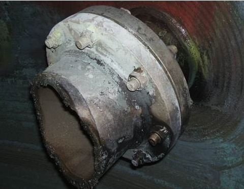

I have a nozzle inside of a vessel that is no longer used and needs to be removed or isolated to remove the pocket it creates that can fill with hydrogen. The setup is a 8" Class 1500 nozzle on the outside of the vessel with a Sch. 80 8" nozzle on the inside of the vessel approximately 5" long with a class 150 flange. I would like to cut out the internal flange and weld a cap in its place. The issue I have is that the pipe/nozzle internally needs to be rated for an external pressure of 1749psig at 650F. The material is C.276 SB575. Sa is 24.6 ksi at elevated temperature. How thick would the pick need to be for the external pressure differential being 1749psig? I have stepped through UG-28 calculation and come up around 1". Hoping someone might be able to verify. OD of the pipe is 8.625. The inside of the pipe will be open to atmosphere.

SnTMan thanks for your reply. MAterial is UNS N10276. OD is 8.625". Length from vessel wall to flange is approximately 5". I have attached an image. If you have any good alternatives that wouldn't result in great cost and vessel modifications it would be greatly appreciated. The vessel is CS with a 304SS liner.

I just ran a quick calc and came up with a similar thickness (~1" pipe)...
Given that you have a sch 80 pipe (1/2" thk), you would also have to remove the internal projection. In this case you might as well just weld a S.E. head directly on the inside surface of the shell, doing away with the pipe completely.
What about going in the other direction? As I understand, the safety concern revolves around someone unbolting the blind. What if you were to go the other way and put a pipe cap on the external pipe? The hydrogen would still be there, but you are removing the ignition source...
RE: Pipe thickness requirements for high external pressure
mechengr12 getting 0.818" for the nozzle, 1.045" for a head, both from plate, although not likely different if pipe. Excludes any CA.
CS w/ 304 liner and Ni-Mo-Cr plate nozzle?
Not sure what to suggest, other than flush patch.

Can you cut out the nozzle at the shell and replace with insert plate (same thickness and material as shell, full penetration butt weld, full NDE)?
At that pressure, and from the picture attached, that must be a very thick vessel (4+ inches). A flush patch would probably be very difficult at that scale. You're probably still best to do something with the existing opening (either externally or internally).
