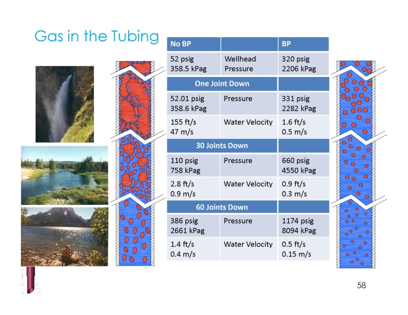

Here is a page from my 5-day course, that (I hope) shows the difficulties that Dejon is talking about. The mass flow rate is identical in every segment. One joint down in the no-BackPressure (left) side, the gas takes a lot of room so the liquid really has to scurry to keep the mass flow rate constant. At the bottom of the well, the hydrostatic head has squashed the gas into a smaller space and the liquid doesn't have to go as fast. The 2 photographs are all of the same water flow and all have about the same mass (and volume) flow rate.

Emmanuel Top. I would hate to disagree with you, but my view is that the flow regime does matter. There is a great deal of difference in the instantaneous liquid velocity between level stratified / wavy flow and a slug type flow, but the analysis will tell you that on average the liquid fraction is fixed and hence on average the liquid velocity is fixed.
As you and zdas04 also note, even the average liquid velocity will change along the line as pressure changes, gradually increasing if the overall flow is steady state. I think "superficial" velocity is just the standard liquid flowrate at some fixed volume fraction. Actual is actual and will vary a lot along the line.

All of the places I know of where superficial velocity is useful re-calculates it at each point in the line (I don't know of anywhere that the average over the line in multi-phase flow would be useful). I don't show gas superficial velocity in the graphic above (it isn't important to that particular segment of the class), but in the left hand example the gas superficial velocity at the bottom is around 4 ft/s and at the top it is closer to 30 ft/s. At 30 ft/s a drag model like Souder-Brown or Turner says it will drag small droplets along with the bulk flow. At 2 ft/s all the drag models say it won't.
