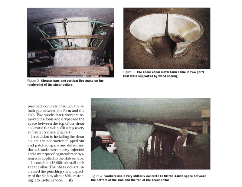

Google "Shear collars save a parking garage slab" by Popovic and Klein.
Here is a part extract. It is a Copyright document.
KootK will like it, hookie66 will dislike it - it uses shear-friction!
RE: Punching shear enhancement.

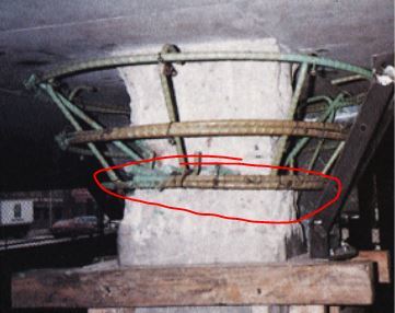

I might not like shear friction as a concept, but in this case don't even see how it is involved. The reinforcement shown in the photo is not in the right place, and is not developed, so how does it help with transferring the shear? Looks like to me that the load is transferred from the slab onto the column by a bearing ledge which has been broken out around the column. The ties just ensure the integrity of the capital. The article says that the circular ties restrain the concrete and provide the clamping mechanism necessary to resist the shear, but I still don't think that is shear friction. Maybe just semantics.
The radial cracking of the slab is due to the top bars being too low, and the WJE report addresses that.
What now? Did somebody say shear friction? Fascinating article.
I've been staring at this for a while now and see things rather like hokie does. Do we have rebar developed on both sides of the sliding planes? Sort of? I guess the hoops are technically developed on both sides of the shear friction planes even if they don't actually pass through the shear friction plane. Compared to conventional shear friction reinforcing, I'd have to think that the hoops would be a good deal less effective at restraining dilation perpendicular to the shear friction surfaces however.
I feel that the collars ought to work primarily by creating struts that fan up and out and ultimately engage the slab top steel, just as would be the case with a column capital cast with the original construction. Were I to be concerned about a shear friction plane, it would be the horizontal plane between the top of the collar and the underside of the slab.

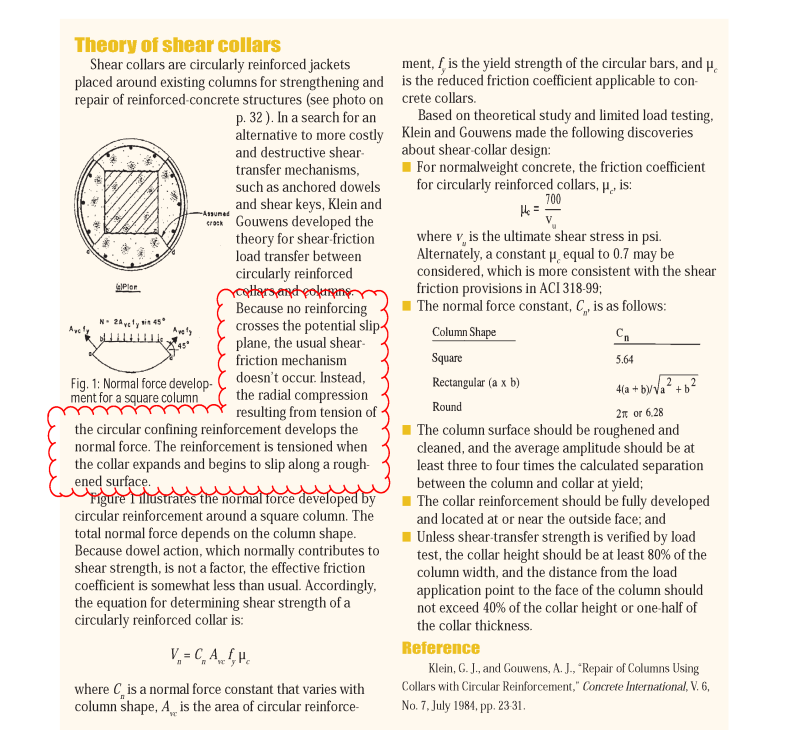

hokie66 see clouded area for the author/s explanation of the theory...
So the theory is that ring tension provides the necessary clamping force. That is quite simple, but I wonder if these collars actually work that way. Do you know if these authors actually determined by instrumentation that the bars were stressed enough to provide the clamping? As with the other type of shear friction (and crack control reinforcement in general), I fail to see that the yield strength has much to do with the clamping force, as surely you don't want the bars to yield, so it shouldn't matter what grade of reinforcement is used. Elongation is what matters, and E is the same for all.
It appears that they've done their due diligence with this so I'm happy to award them some KootK innovation points. When I first read the article, the first thing that occurred to me was that I would be nervous about implementing such an unconventional shear friction application without some test results. And it sounds as though they've done some testing.

I'm late to this topic but find it interesting. And particularly interesting to me is the following statement from the article:
The radial compression resulting from tension of the circular confining reinforcement develops the normal force. The reinforcement is tensioned when the collar expands and begins to slip along a roughened surface.
What causes the collar to expand? Simply slipping wouldn't do it. I could envision it if the column were chipped away in some type of inverted cone shape whereby slipping would cause the collar to expand, but not otherwise. And I wouldn't think that that ledge would serve that purpose, at least, not without first crushing or crumbling a fair amount of concrete at the interface.
Archie264, the roughened interface amplitude is the 'key'.
If there was a smooth (or no amplitude to the) interface, then no normal force would be developed. For sliding (vertically downwards) of the collar to occur WITH a roughened interface it must laterally 'thrust' the collar and engage the circumferential reinforcement, that provides the clamping force.
Similar to the typical/conventional shear-friction we use with rebar developed perpendicular to an interface - for slip to occur the section tries to 'rise' over the roughened interface amplitude, which is prevented by a clamping force of the developed rebar.

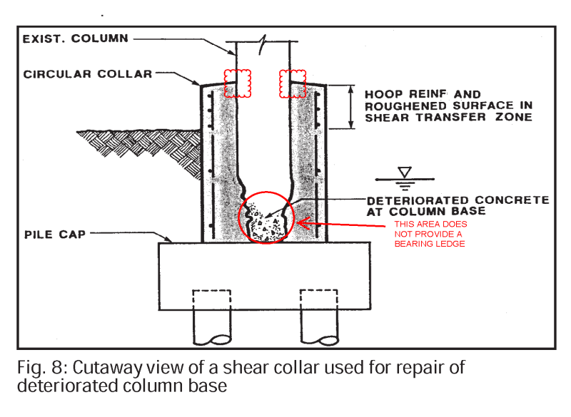

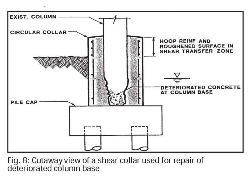

hokie66, In the column base/pile cap example the concept is the same as in slab-column junction strengthening, EXCEPT that the loads are acting in opposite direction, so the bearing-ledge would have to be at the top of the collar (clouded areas in the sketch below) to achieve what you refer. The chipped base area (circled and noted area in the sketch below) will not provide a bearing-ledge for the direction of loading in this case.
I agree that 'active' prestressing forces would enhance the shear-friction model.
Quote (hetgen)
And you think the vertical shear force is handed by pure friction on the same slip surface. you could be right but I don't see this collar slipping vertically down, as hokie stated above and on his previous post there is a bearing ledge around the column ( see clip below) and in addition to that what about the resistance from the existing slab?
If there is a bearing-ledge, then I agree that what was once a primarily shear-friction concept (as calculated-designed) becomes a predominantly strut/bearing ledge, BUT the authors concept is NOT founded on a bearing-ledge basis.

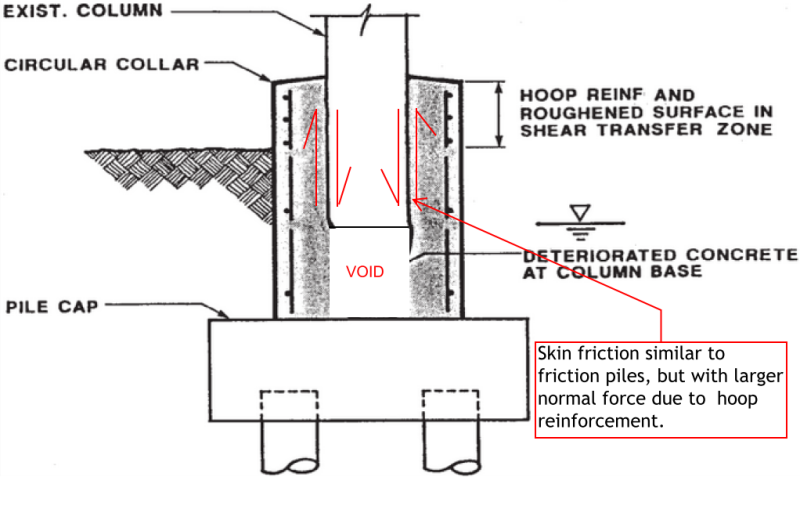

Ingenuity,
With regards to the column base repair, I think if we have a void below the existing deteriorated column as shown below and rely only on skin friction between the new collar and existing column we could say no bearing.
Thanks ingenuity, i think the column base example is easy to understand, and if this hoop tension is formed as they claim and enough shear friction contact area is provided it should work.
