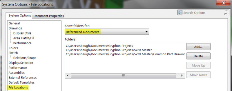

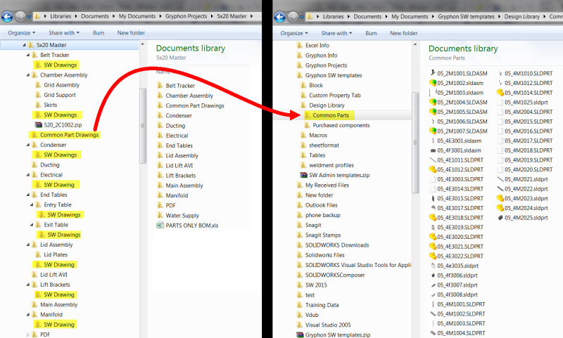

I get that all the time and even though I have placed the path in the referenced locations it still fights to find it, sometimes it does, but most of the time it does not. My thought is that I would have to place a path for every single drawing location, which is way out of the question for anyone to do... IMO. If I place a path that is above the hierarchy of the tree, then SW should browse through all sub-folders to find the cooresponding drawing. However I don't think it does.
For example look at this attached image. This is how my tree breaks down per project.
Each module of the machine has its own folder and within that folder I have a "SW drawing" folder (highlighted in yellow) that just has the drawing saved there. IMO creating folders like this makes it easier to find when searching for a drawing. Instead of browsing through file after file. (FYI we do not currently have any PDM in place, working to fix that soon). However notice the Common Files on the right. Those common files don't have any drawings within the design library, the drawings will be listed per job, because the QTY can change. So I cannot have a standard drawing for each part. You might be asking why that is, its because we have a manual property that we list the QTY per part on the drawing. The reason for that is because of the people we have fabricating these parts for us need the QTY on the part drawing. Plus they won't see the final assembly BOM.
However back to the question... Each job I will have from the Master file will look like this except the Part numbers will have a prefix. Which means if my thought is right then I have to add every one of these paths to the SW references, which in return also means that will have to add them for every project we create. Which I am not going to do. But if I place the paths in SW explorer it does look in Sub-folders and it does find the drawings. That tells me SW does not have this built in functionality and is the reason why it cannot find the drawings. This needs to be an Enhancement request and voted on next year during the top ten for 2016.
So my suggestion for you is to make sure you have drawing path saved under Tools\Options\System Options\File Locations\Referenced Documents like shown below:
