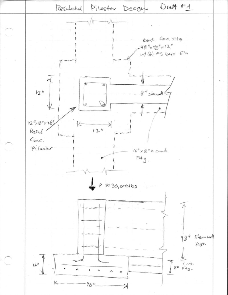

Has anyone ever done a pilaster at the end of a stemwall in a residential design? I have a large point load at the end of a 8" x 48" high stemwall and I am thinking this is the route to go. Are there any prescriptive resources or design guides/spreadsheets?

This is kind of what I have in mind:
However, not ever having to design or engineer one of these before has me asking a lot of questions.
First and foremost is how to size the pilaster given the loads and the attached stemwall thickness and also that it is an endwall in the stemwall foundation. 30,000 lbs is not really much when it comes to concrete but when I thought about this much force at the end of an 8" stemwall it did give me some concern.

The detailing appears to be headed in the right direction. As for evaluating the capacity:
1) If you go with the pier, you'll probably want to design it as a concrete column per ACI.
2) If you want to stick with just the wall, there are provisions in ACI for designing walls with concentrated loads that you can use.
When evaluating the wall on its own to resist the point load, it's kind of a tough call to evaluate the bracing situation. If one can count on the soil and slab on grade to brace the wall completely, then you can basically just use the bearing strength of the concrete which would probably work. Certainly if this were a wall corner condition, I'd considering going that route.

a short 8"x12" column as you've designed it would easily hold that. The issue is when you start to account for bending as well that the capacity drops.
I would be checking for bearing capacity under the post but then again, the wood post would govern. and then I could see the load spreading to a 2' wide strip almost, I think only saying 12" is conservative.
are you planning on putting ties around additional bars?
I've put 38 kips on an 8" foundation wall before without even thinking about it. Although my 38 kips may have been more conservatively determined than yours.
RE: Pilaster Design in Residential Stemwall
In reality what I have is a 6x6 LVL post with about 19000 lbs gravity loads coming from the glulam beam above and then a 6x6 chord of the shearwall next to the post with about 9000 lbs tension/compression from wind. So in actuality the the load will be spread over a 6"x12" area roughly, with the bulk of the load on the 6x6 end post.
I think a 8" wall could easily hold the load but if it was in the middle of the wall but I'm applying this point load at the endwall situation, my worry is the concrete spalling or shearing off in some weird failure mode that might be hard to account for.

If you hooked your horizontal bars and maybe provided one or two extra near the top you'd likely be ok.
Explain the hook, I'm assuming its a 180 degree and it extends back on itself for a foot or two to achieve further development.

I was just thinking a 90 with a 6" long leg that you turn each bend towards the other wall face, essentially turning your horizontals into a stirrup of sorts at the end. I know you aren't getting enough embedment length but it's better that nothing. On second thought, I think I like providing hairpins at the end of the wall to confine the end two verticals.
I'm just suggesting things to try and mitigate your blowout concerns. I actually think your spalling/splitting concerns are reasonable, I can picture a wedge of concrete at the top of the wall trying to come off.
Jayrod12 I think you've hit on the appropriate solution for this situation. I will provide a small detail with two vertical bars at the end wall and the horiz. rebar wrapping around them and then back at least 24". This should be a good compromise between a full column/pilaster design and no treatment at all. I just found a similar detail online that deals with an endwall in almost the same manner.
I think capacity was never as much of an issue here as was my concern of a "blowout" at the end/top of the stemwall. I appreciate everyone's suggestions and help. I now have two new spreadsheets for concrete columns and walls as well as a much better idea how to deal with concrete walls in the future.

Here is what I have so far:

I bet the contractor would rather just provide hairpin dowels with a 24" leg on each side as opposed to being the horizontal bars. Just for constructability.
And that would likely be ok in my eyes.
I would tend to agree, here is draft #2:

I like that detail, might even consider making the hairpins 36" long each leg so you are sure you're getting embedment depth past your inboard pair of verticals.
But that's just a "feel" comment and they're likely ok as you've shown.

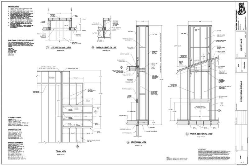

Hey medeek, sorry, hijacking your thread...but I have been meaning to compliment you on your CAD drafting, and most especially your color shading on wood members. Do you use AutoCAD to produce your drawings, and if so, do you use "hatch" or some other command to get the color rendering to wood members?
Thank-you. I sometimes like to shade the wood since if it often confusing with some of these details as to what is empty space or framing. I use AutoCAD with a solid hatch.
I've got a few drawings posted here that you can open up and look at the shading and the colors I am using:
http://design.medeek.com/cad/cadlibrary.html
The only downside is the extra time and effort to apply hatching to the framed areas and then to make sure they are behind all of the other line and text objects.
I also like to use a bit of color in my drawings since I think it helps differentiate things like structural notes, dimensions and physical objects.

I have played with the colors a bit over the last year and the goal is to use the effect minimally. If the wood shading is too dark it becomes distracting and overlaying dimensions are also harder to discern. Just enough color to indicate the wood framing.
For straps I've starting using a light gray shading with a blue outline, to help differentiate from wood or concrete objects. However, I'm not sure if I'm sold on the dark blue outline yet.
I'll admit I was influenced by different framing textbooks (Dewalt etc...) in my methods.
I'm not sure why I started using dark green as my dimension color but it somehow stuck and I am a creature of habit I guess.
For structural floor plans I use a light shade of gray for the walls, dark enough so that the walls pop out at you but light enough so the location of the holdown anchor bolts is clearly visible.
I've created a vast number of blocks so inserting windows, doors, posts etc... is fairly simple.
For structural notes and tables I like to use a dark blue to set them apart from my dimensions. I borrowed that idea from one of my mentors.
For shearwalls I use a deep red with a dashed heavy line weight.
I use the flux architect font by Clayton Cowan, mostly because it was free at the time I was looking for a suitable font, however it is missing a few important characters like the degree symbol but AutoCAD deals with this just fine.
The drawings really pop when you print them out full size at 24 x 36 (Arch D):

My philosophy on drafting is that with only four key variables some amazing drawings can be created. Those four elements are:
1.) Lineweight
2.) Line Type
3.) Color/Grayscale
4.) Hatch Type
