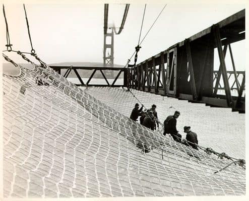

Have any of you encountered or utilized a net or something similar that can provide protection from falling tools? We have an open area 30ft by 30ft between steel beams that we would like to put in place some sort of net or temporary barrier to stop the fall of up to a 70lb tool from a fall of about 50ft.

What about the nets they used for fall protection in bridge work? If it will catch a 200lb ironworker, it should work for a 70lb tool. They usually were a lot less than 50 ft below the work area, though.

If you are considering a net, I would suggest layering two nets with a separation between them. The reasons for this are that if a single net is 'tight', the tool will tend to bounce off the net like a trampoline. Set the first one 'loose' to absorb as much energy as possible. If for some reason the first net lets go, a significant percentage of the energy will hopefully be dissipated and the second net will arrest the tool. I would look towards cargo netting or possibly the mesh they use in NHL hockey arena's to protect the attendees from errant pucks in the end zones.
The fun part will be setting up a test area of netting and dropping a tool from height. I have done this with layered plexiglass panels intended for protective canopies at building entrances.
