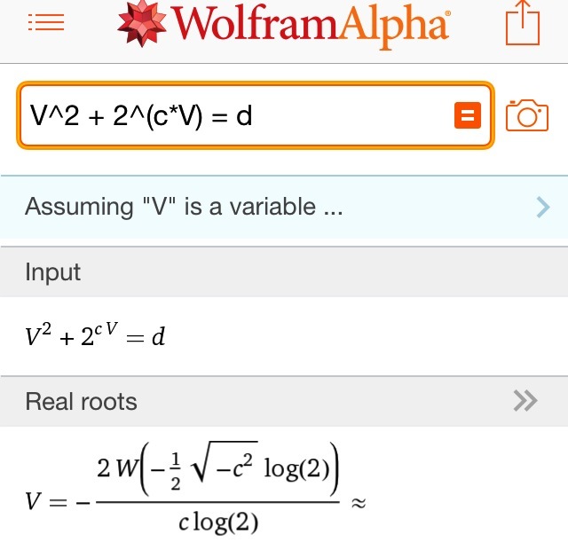

Can anyone point me to the proper function/procedure to solve this equation for V?
V^2 + 2^(c*V) - d = 0 (so V is added and in an exponent at the same time).
Or am I going to need to approximate it? I'm a bit rusty on the math end.
Thanks,
Z

I entered it into Wolfram Alpha, but with the "- d = 0" trivially modified to "= d", and it offered a V = type solution straight away.
Trying again exactly as presented "... = 0", and it didn't offer up the V = solution.
Now, let me see how to post it...
RE: Exponential linear equations
This is a cropped screen capture posted here using ET's new feature.
The solution shown is "=" and is thus supposedly exact. Further down the page (not included here) it offered approximate numerical solutions.
Wolfram Alpha is, in general, often extremely useful.
Is this solution correct? Best to double check.

Very elegant and convincing!
But, excuse my ignorance, what does W stand for? Is it a secret Wolfram function?

Thanks! Interesting how the location of 'd' could confuse the solution. I was wondering if a 'Lambert W' or a 'glog' solution would work; all this new math!
V is velocity for a motion profile that I'm working on.

Unfortunately it seems like the Lambert W function is not something for which you can easily solve. The Wikipedia page shows that it's only defined as an inverse relation. I think you're still going to need to solve this numerically.
