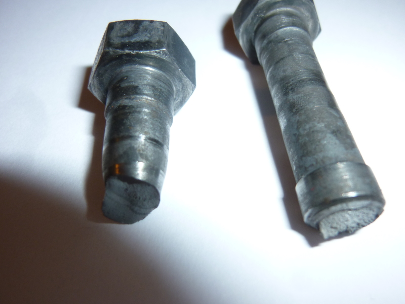

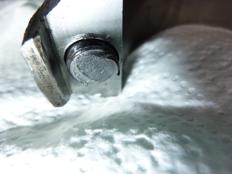

I'd like to see more close ups of the rod bolts, especially the fracture surfaces.
RE: Piston broken in half(top-bottom)
Thanks for the pictures.
The 55 lb/ft installation torque you note seems high for a 3/8-24 UNF bolt having 110 ksi UTS, especially if the threads were lubed at assy. You might want to do a quick calculation to check if the combined tension and torsion forces at installation would be enough to overstress these bolts.

110 ksi UTS is not even grade 5. I did a quick check for 55 lb/ft torque on a 3/8-24 UNF bolt with lubed threads and it exceeded 110 ksi at the thread root. Given that both bolts appear to have experienced similar failure modes, where they parted right at the thread root section closest to the mating internal thread, and right where you would expect to see a stress concentration, it seems like this might be the result of excessive preload.

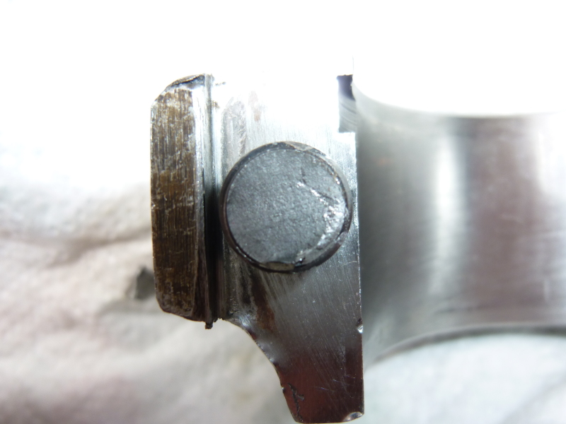

I tried to make some closer fotographs.
No bottoming,holes go straight through.Torque is factory one.New ones are not marked,an old one shows 55T65;I assume this is 55t/sq.in.,which is not bad.The conrod and piston assy is quite heavy;combined with a long throw(89 mm)will put a lot of pull when overrevving.MGA twin cam conrod bolts were a failure cause in the past for race engines.Would have loved to put ARP in but they do not make them in 2".

Grade 8 3/8 UNF recommended torque is 49 lb ft, dry, half that lubricated. Grade 8 bolts are 75 tons per sq inch. You fitted 55 tons per sq inch bolts and then torqued them to 55 lb ft.
They broke.

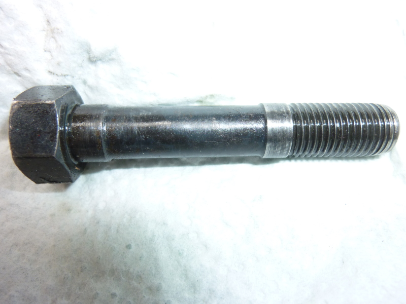

Well,I did some tests with oiled bolts:
Static length was 61.47 mm,
At 70 LBS/ft 16.59(overloaded 20 lbs/ft to spec.
At 80 Lbs(serious overload)61.62 mm
When released, bolt measured 61.49,just within elongation spec?
At 90 Lbs/ft,bolt broke. Other one broke at 85 when torqued up slowly,showing narrowing and torque damage

I showed the bolts to a metallurgist and he immediately used the words: IMPACT SHEAR, without knowing what happened.
I always wondered why the conrod bolts would have gone first,as there is clear evidence of the piston broken in tension.
Shure enough,some searching on the internet brought the following: "Impact shear of conrod bolts often happens when there is a blockage of the rod in an engine due to breakage of other components,like camshaft."
This leads to the following:first the piston broke in tension(ewhaust phase). Top of piston is thrown against head,valve blocage and hence OHC broke.Next crank throws rod against remains of lower side of piston,smashing it to pieces and bolts break on impact.
I think this is a more logical line of thought.

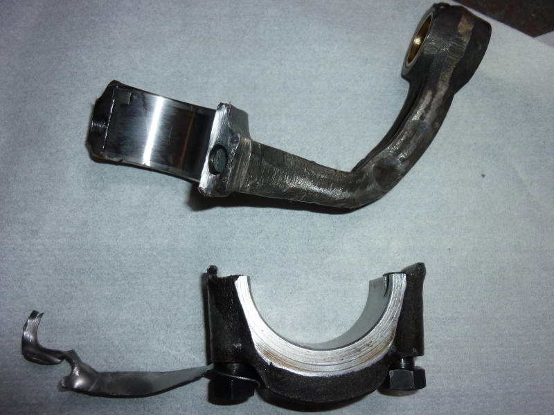

If I was betting on it, I'd bet the rod bolts broke and then the rod was twisted when the crank came around and hit it which smashed the piston.

The pictures of the rod cap parting faces seem to show a fair amount of fretting. This would indicate they were separating and smacking back together for more than just a couple cycles. If the engine was over revved the fretting may have occurred after the bolts yielded from inertia loading. Or it may have been the result of the cap not being clamped tightly during assembly. As Tmoose noted, it is possible the bolts may have bottomed out in the blind tapped holes of the rod beam leaving a gap at the rod split face. Even a small gap between the cap and beam faces could produce significant impact loads on the rod bolts around TDC of the exhaust stroke.

Need to see all the parts.

BMC B block - rod cap is angled, not a horizontal cut. Rods not fitted backwards by chance? This would put tension on the rod bolts on the power stroke.

I fail to understand why most of You want to point to the rod bolts.
1)OEM bolts,torqued to factory figure.
2)No bottoming of bolts,angled right way.
3)How do You explain that the piston broke in half after the rod let go as there is minimal damage to the cyl. head and top of piston.
If the rod let go first there should a lot of damage to the top of the piston and cyl. head
4) The top part of the piston shows no damage by the rod smashing into it,break line is practically untouched.
5)It is the bottom part of the piston that caused the blockage of the rod.(Nothing left,gone in smitheriens)

The reason we look at the bolts is you claimed they were "Bolts are 55 Ton tensile", torque specs for which are readily available. If they aren't 55 ton material, then sure there could well be other explanations.

I assumed they were 55 t/sq in. as I said the OLD ones were marked 55T65.This being old English markings I am going to send the remaining ones to be tested further to make sure.

I don't think it would be easy to bend a rod 90 deg like that without breaking the bolts.
Just wondering,as the rod is angled,and the piston broke first,whether there could not be shear implicated.
When the rod is blocked there would be side pressure on the cap lips as well.They are not designed to take those high loads and could move a bit sideways to create shear on the rod bolts.I will examine the cap's lips again.
I talked to some other guys and the piston breakage on those older engines is not uncomman when overreving.

"The 55 lb/ft installation torque you note seems high for a 3/8-24 UNF bolt having 110 ksi UTS, especially if the threads were lubed at assy. You might want to do a quick calculation to check if the combined tension and torsion forces at installation would be enough to overstress these bolts. "
I put this torque (55 LBf-ft onto 3/8-24 stud/nut) in my thread stress software, inputting nut to base friction coef = .18, nut to stud threads coef = 0.18, (lubricated threads and nut seat)comes up with stud princ. stress = 136ksi! Not lubed, friction coef = 0.3, gives less than 100ksi stress.
To FredRosse:I mentioned 45 ,lubed as given by manufacturer of rods,and I think ARP as well.I have a racer with Cunningham rods,same spec.
Dirk
Your close up of the failed bolts clearly shows that one of them has the tell tale "beach marks" indicating that it failed over more than one cycle and not catastrophic like the other. That bolt fracture went catastrophic after about 3 cycles based on the beach marks and the other bolt is a pure catastrophic tension break, likely from the rod cap leveraging it in tension after the first bolt broke. The first bolt that broke also has a pulled thread and a slight lean opposite the failure origin (center OD of 1st beach mark) indicating that the cap was bending about the remaining bolt, causing the extreme tension that failed the second bolt catastrophically. BUT, pictures alone can be a bit deceptive.
Hi
I have followed this thread with interest for quite awhile now and one thing that caught my eye is that the original bolts were torqued dry to 6.9kgm, well torquing bolts dry can leave a huge variation in bolt preload +/- 25%, so is it possible that preload variation allowed one bolt to see more of the load than the other?
If so this might well support the theory of the last poster who suggested one bolt failed first in fatigue and subsequently followed by the second bolt.
Just a thought.
The reasoning is right,with the exception that the bolts were new and engine only did 50 miles in total. I would not expect fatigue marks on an engine which is basically still running in?I gave the rod to the University lab and they will examine it next term. Will keep You posted then.
Dirk
hi dirk
Thanks for the response.
I don't think something being new would exclude it from failing in fatigue and besides how many cycles would the piston do in 50miles, it may also be a small flaw in the bolt material itself which wasn't detected.
Anyway it will be interesting to see what the university says.

There is something called "low cycle fatigue". And 50 miles of driving could easily put 1x10^5 or more fatigue load cycles on the rod bolts. If the failed bolt had a defect, was over-stressed at installation, or was over-stressed during operation, it could easily have failed in low cycle fatigue.

I have approx. 10 years in building engine's as a full time career at 5 different facilities covering oem rebuilds to 1000Hp forced induction applications. This would be the first time I've seen an over-tqd rod bolt cause a chain of events to damage a piston like that. I am curious how close the crankshaft counterweights come to the bottom of these pistons. Older engines had heavy piston castings and longer than average strokes. This is what mainly seemed to determine their connecting rod length, which varies a lot within engine models year to year and displacement sizes. This combination doesn't allow for much rod twist/bend, bearing play, or even part combinations before the bottom of the piston is contacting the crank counterweights and fracturing the bottom of the pin bores while in turn putting the rod bolts in excessive tension.
The only assumption I can make here is the rod bolts broke after the counterweights fractured the piston. The g-forces on a heavy piston are high and at TDC I'll bet the pin was pulled through the bottom of its bore after it was weakened. However the rod bolts broke after that is anyone's guess.

To Panther 140:the rod and piston are at the University as a project,will get results in april/may.
Investigation of the other rods showed that the thread was torn out partially on several of them.
That can only happen when a very heavy pulling load was applied,which makes the overevving plausible.
