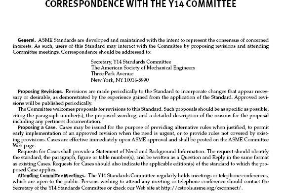

You can submit recommendations to the Y14.5 committee here:
RE: ASME Y14.5-2009 Errata sheet?
I know. They are not acted in a timely manner, certainly not to fix errors. Since each release is farther apart, 1982-1994-2009, the next release should be in 2027.
