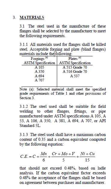

Is it the chemical requirements for A105, A53, A106...etc. or is it flexible?
RE: MSS SP-44 Chemical Requirements
It is the chemical requirements of one of the mentioned material specifications, in the Table.
