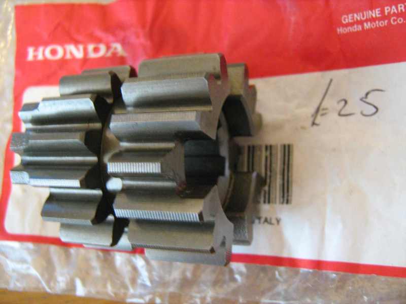

I just got my hands on the actual part in question. (See below image).
This is one of the last items available before becoming obsolete, and its marked with the actual price, and that's only within the last couple of years!
How on earth can they make a profit at that price, even if they are mass produced.
I bought similar gears 20 years ago and they were 10 times that price.
The gear as per my model above, from another company for a different motorcycle, costs about £150 retail.
To be honest, I don't even know how that company selling the £150 gears are making a profit, since they're just being re-manufactured in small batches.

Sorry, I meant to ask, with these type of gears, where two gears are combined as one, how are the tooth profiles finished? In my ignorance, I only presume by looking at the tooth surface finish, that they are finish ground, but I can't see how that a grinding stone could access the whole tooth profile without gouging a chunk out of the neighbouring tooth?
I'm only assuming the tooth profiles are ground purely because I see no witness of machining, but as I said, I've no experience of witnessing an actual gear coming from a hobbing or shaping process, so I'm not sure if such a finish can be achieved by hobbing / shaping. Could you please enlighten me. Thanks

If a Honda dealer was asking say 150 Euro retail for that gear, it probably only cost Honda around 10% of that to manufacture it. The original manufacturing cost of spare parts is small compared to the cost of keeping the part in inventory for several years, or the 200% mark-up added by the dealer.
The teeth on that turned gear blank were probably first shaped, then shaved to add profile mods and/or compensation for heat treat distortion, then heat treated, and then possibly given a finish hone to improve the flank surfaces. But I doubt they were ground. This gear was produced in quantities of tens-of-thousands using dedicated production facilities that cranked them out 24-7. So it would only cost Honda (or their supplier) a few dollars per part. Companies like Honda are very good at making the most of materials, heat treating, processing, etc to minimize the cost of a part like this gear. A good example of this can be seen in the rough turned surface on the gear tooth tips. You can see the blank was machined very aggressively and quickly to reduce cycle time and save money, but the surface finish there is not important.
